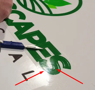

    I’ve been having issues when cutting MD5A, with their gloss Laminate using our VF2, running TR2 inks.
    When cutting, the pressure seems uneven – I can rule out the cutter as it performs perfectly cutting CAD vinyl, and the issue occurs on both our Graphtec & Roland Cutters.
    Doing a test cut, it cuts fine on the unprinted area, but when cutting where inks are laid down, the pressure appears to increase. Either cutting through the vinyl fully or snagging it on smaller details.
    Roland claim 6hr outgassing, these were printed yesterday AM, left overnight, laminated this morning then cut. Not quite 24hrs, more 22.
    I’m inclined to think I need to allow longer to outgas, although never had a problem with our OKI, or the VersaArt, both solvent printers.
    Just uploaded a video of me weeding a logo.
    Green weeds a treat, the grey is a bit of a bugger, and the unprinted area doesn’t weed great. More pressure it cuts through the printed area, too little and the unprinted/grey area doesn’t weed. – https://youtu.be/R0_CZoODvss

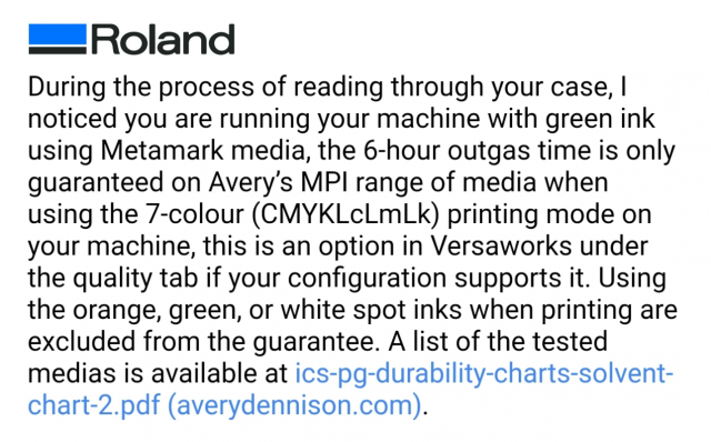

    I spoke to Roland today, they agree it sounds like outgassing issue, but they were surprised as it was 22 hours. That said it’s not something they’ve come across with the cutting and it only affecting certain printed colours more than others.
    That said, they did suggest standing the roll on end, loosely wound, should help the solvent fall away. We’ve some birch ply over from a job so have ordered two fans and will knock up a box to draw the air down over the rolls.
    Their other suggestion was it may be the hot laminator causing and issue and to try cold laminating?
    I’m confident it’s an outgassing issue, but the 6hr claim must only apply if you’ve printed pantone 7603, on a Monday, following a full moon, with an easterly wind not exceeding 4mph, for a client called Brian. 🤨
    No manufacturer of material, inks, machinery, seems to give any indication on how best to outgas prints.

    I know you have tried various vinyl etc. and did not have a problem. but i would suggest trying a brand new blade and getting the pressure to cut light, but not making a mark/score in the carrying liner. see how that goes?
    Also, looking at the freeze frame of your video, I can see that the pressure is too high on the blade or the blade is on its road out. this creates the appearance of more of a
    chamfered cut, which catches the light much more, making it very visible like in the attached photo.

    You’re right Rob, the pressure is too high on the green, but then too low on the grey, despite it being fine on the test cut on the unprinted area before cutting.
    I’ve ruled out the blade using a new blade.
    The cutting strip is OK, and if it was the strip would affect all areas that are cut in the same spot. I’m reluctant to change it just to damage it whilst we have the issue.

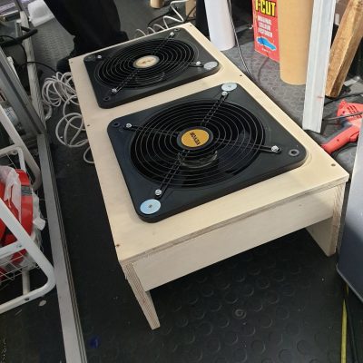

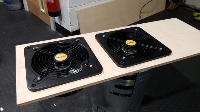

          Back to the problem in hand, we’ve to two large extractor fans, and will be modifying a cupboard into an drying unit, with heater element at the top, and fans to draw the air down through the bottom.
    December 20, 2021 at 4:51 pm
    2x 10inch, 240v fans have arrived to aid the outgassing process…
    They certainly shift some air – https://youtu.be/I8mAr0M3wP8
    December 21, 2021 at 10:29 am
    Did someone say air flow aids outgassing 😂
    Fans are fitted, in the new year we’ll make to ‘chimneys’ to fit around them, to house the graphics, and install a double switch so they can be turned on & off separately.

      Tidy bit of work there David. I built something very similar a few years back to aid drying although we still struggle with the prints from the VF2-640. Your fans though are huge compared to what we’re using, time for an upgrade for us I think. Where did you buy the fans if you don’t mind me asking? Something you might want to bear in mind if you intend on sitting the rolls directly on top of those fan guards is they’ll bend pretty quick with the weight of the rolls. Might do no harm to make a “X” shape out of some 25mm H x 15mm W laths to take the weight.

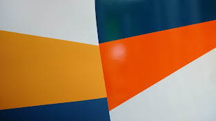

      Here’s a comparison of the orange from our CMYK LC LM LK XR640 vs the VF2-640 with orange ink! Results speak for themselves .

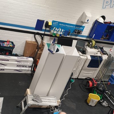

    Here it is in all its glory, the MK1 drying unit.
    Got the same customer booked in on Monday, and the artwork still on the rip, so intend to print the same file, and drop it in here to help outgas, and see if the results are the same.
    I’ve another smaller job at the moment, so have one in the dryer and one hung over the laminator and will see if there’s a noticeable difference.

    We’re trying and we have a bit of a conclusion.
    The fans don’t have a speed controller (yet) and are set to suck only. They were sucking so hard it caused the media to draw together when loosely rolled, so some masking tape to reduce airflow resolved that.
    We left the prints in about 20hrs, and laminated this morning.
    1 set we’re putting through our Roland GR cutter, it behaved mostly, with the exception of some smaller text which for some reason it decided would go through the backing! Tried a new blade, and a new red tipped blade which is a smaller diameter point, and the same occurred. Cutting strip is (was) new too. It’s snagging, and dragging the text, lifting if off the backing.
    The second set are going to be cut on out trusty Graphtec FC8600, and I don’t anticipate their being a problem..
    So yes the unit does appear to have aided the outgassing – However, we’re still not entirely satisfied with the Roland Cutter.
    I’ll update how things progress!

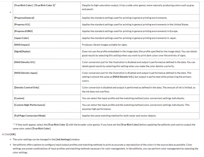

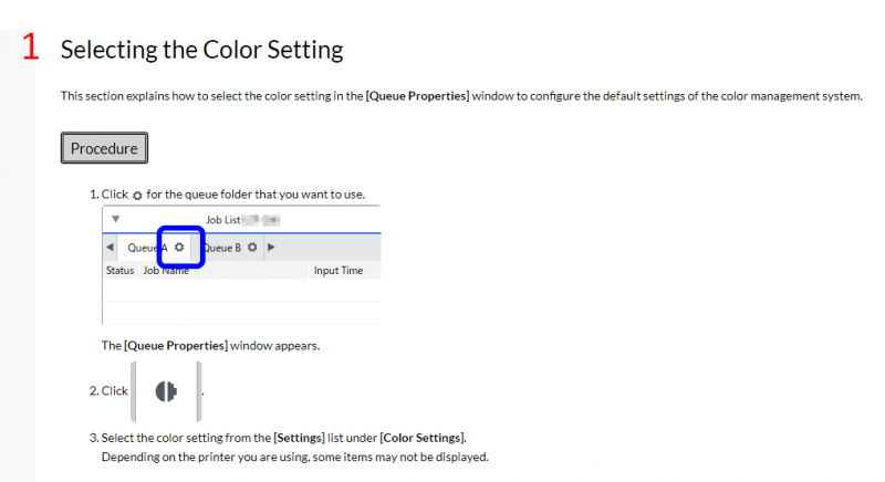

    @David-Stevenson I’m using the MD5 profile, from metamark for our machine & ink. I also have the profile for Arlon SLX too.
    I noticed yesterday that the Colour Management Preset in VW was set to “True Rich Colour 3” and it is designed for the green and orange ink, to widen the gamut of colours.
    What I’m going to do next week is print a test file, and change this to other presets.
    If you duplicate the job in the queue, nest them, you can change each one individually by selecting it in settings and see side by side how they look.
    Here’s a link to Roland’s website with the different presets, and there’s an hour-long webinar on YouTube I watched yesterday that explains some of the advanced settings in much more detail.
    https://downloadcenter.rolanddg.com/contents/manuals/VW6_English_R6/topic/tSelectingTheColorSetting.html

    Done some test prints this morning with a file I created over the weekend.
    Using the True Colour 3 setting, on the photoprint the colours bleed into each other.
    Using the MaxImpact this doesn’t occur and the colours remain vibrants
    Using the Euroscale, and sign & display some colours loose their vibrancy.
    All printed using the correct MD5 profile, just changing the colour management settings. Perhaps MaxImpact lays down less ink?

    I then enquired with Roland as to on what basis they make the claim of 6hr outgassing, and what testing they have done in order to make this claim.
    Roland’s reply below:
    “Tests performed by Avery Dennison™ US on MPI Range digital media. When using this media, prints produced on VF2 and VG2 with TR2 ink can be laminated after a 6-hour period when rolls or images are properly ventilated and loosely wound. For more detail see:”
    Anyone that knows me, and my interest in law, I’ve gone back to clarify a few points.
    1) The inks were tested with 1 media, and in the US. – Yet the inks, and machines are advertised as “6 hour outgassing” around the glob, with the above detail hidden in the footer. I’m sure most will admit that this restriction was not advertised clearly at the time of purchase.
    2) images are properly ventilated and loosely wound” What exactly does this vague term mean? What is “properly ventilated” and what is “loosely wound”.
    The entire claim of 6hour outgassing is borderline farcical, unless you’re in the US, using Avery Media, and understand specifically what Roland refer to as “properly ventilated” and “loosely wound”.

      February 17, 2022 at 5:11 am
      I can’t remember the site, but search vevor fans 👍
      • Darren Summers
        February 17, 2022 at 1:23 pm
        I found their website but, all seems to be sold out.
        Nevermind.

    Well, there it is in Black & white, from Roland themselves.
    Can’t see that on their marketing materials and links they provided.
    Not that 6hr is what sold me on the machine, as we can afford to leave it longer, but the green and orange inks are why we purchased it. Even after leaving the prints 24+ hrs still it doesn’t outgas fully. Its defies the point of having or & gr, might as well have bought a latex.

      We’re not being guinea pigs, we’re blatantly being lied to. 😡
      Nowhere does it state the Orange & Green inks are not covered by the 6hr outgassing. Roland clearly knew about this, but instead have tried to lay blame elsewhere, before finally acknowledging the fact.
      Compare that with the HP latex machines. They have HP Latex Certified media, I can go on the Metamark website, and download the certification, with the specifications of what settings were used for the test.
