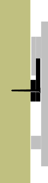

    Thanks George, that’s what Andy was suggesting. I suppose it wouldn’t look too bad with it 10mm away from the wall.
    My other problem is if they want me to only supply so they can fit, would this still be the best way to do it? It would still be easy for them I suppose 😕

    This might be a stupid question but how to you cut the 45 degree angle 😕

    Manfred Didier uses this type of fitting, it comes in lengths, fix a strip to the wall and small pieces to the foamex, I think he may be able to supply you some, maybe to late for this job,, but its a commercial version of Andy’s Idea
  • Steve Morgan
    September 20, 2007 at 3:16 pm
    An idea I used some time ago to get myself out of trouble when the shops were shut.
    A bit of a bodge really because you need to glue 6mm and 5mm strips together to make the hook section and then another piece on the bottom of the panel to keep in hanging vertical, but it works provided the lengths aren’t too long and you make sure the glue joints are sound.

  • Ian Higgins
    September 21, 2007 at 11:24 am
    The first drawing on here is called a Johnsons Cleat!!
    Got a spec sheet for a job we were doing from the USA and it kept mentioning the fixings had to be Johnsons Cleats.. Took ages to find out what one was!!

  • Warren Beard

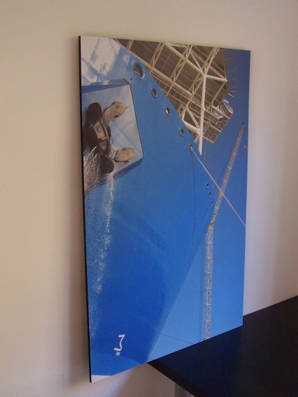

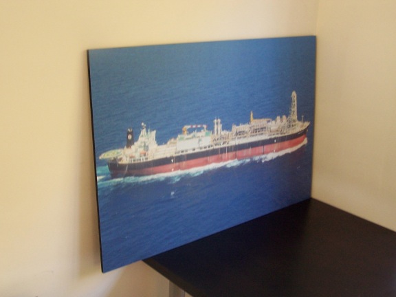

    October 11, 2007 at 8:26 pm
    quote Steve Morgan:
    Steve
    Update, used this method in the end but only used 5mm foamex bonded together, all went well and all the brackets fitted in to each other no problem.
    Thanks for all the input.
    cheers
    Warren
    (p.s – Thanks to Dave Rowland for the help with the prints)
    October 11, 2007 at 9:16 pm
    they all look propped up on a bench to me Warren 😳
  • Warren Beard
    October 11, 2007 at 9:26 pm
    :lol1: :lol1: :lol1: :lol1:
    I thought the front looked better than the back :lol1: :lol1: 😉 😉 😉 😉
