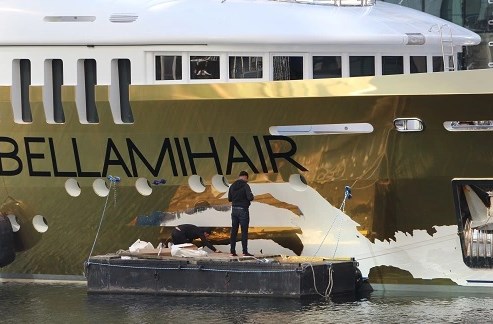

Some will edge seal the vinyl with a liquid, some will use an overlap of clear, while others use nothing. by that, I mean large panels that the edge is directly being hit with the water in the direction it’s coming. if that makes sense?I said multiple times in the past that I am not keen on the likes of air-release vinyl being used on boats. but as I have also said above, a great many do it regardless and have no issues I have heard of.

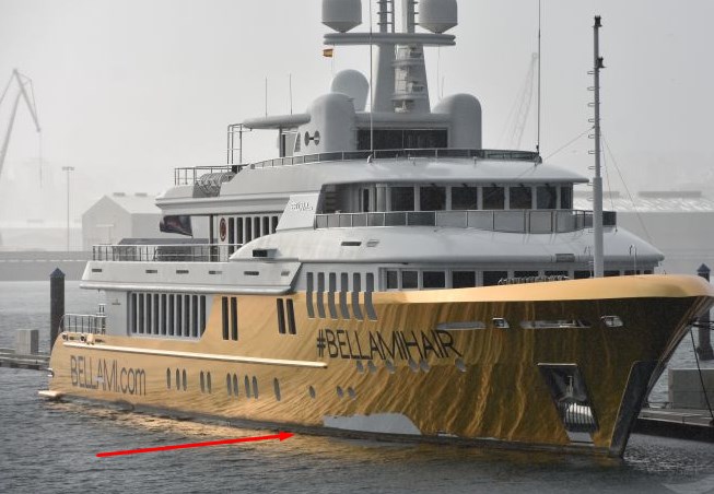

however, this gold-wrapped boat did fail multiple times and there could be various reasons for it, but in my opinion, the air release adhesive system is the wrong type for this application.
My logic? if air can get out, water can get in!here is a link to an old editorial we did…

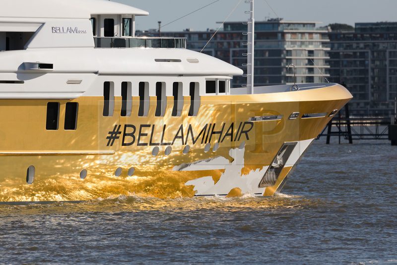

I agree Martyn, but I think when it comes to fast-moving boats or those out at sea exposed to the elements for days on end, the waves kick up the boat can take a pounding.
this is the boat above showing wear and tear! 😬🤨

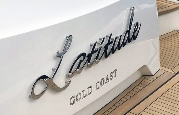

i would be confindent in acylic doing the job just fine but stainless syeel is obviously your safe place
I would go 10mm acrylic but seeing these things bumping off quaysides & moorings, I’d rather suface mount with a double sided tape instead of stand off locators
That “looks” like a proper chrome dipped, 3-4mm buffed edge aluminium raised on polished stainless locators.
The lower section just looks like cut vinyl. But could also be paint with Silverleaf, clear coated and polished.Obviously, you know the size and value of this boat and the money behind the owner.
If they want it done right, then give them it or they will go elsewhere! What is expensive to you and I, is not looked on in the same way.If you are unsure, give them two options, what is being suggested here and what you see in that photo. But be sure to charge plenty for your time and effort, and of course, the professional installation of it on an expensive boat.
don’t get me wrong, laser-cut, polished edge lettering like this in 10mm acrylic would look amazing too. but if it’s low down like the one in the picture, it could slice the leg of a staggering bikini-clad sun worshiper walking past in flip-flops with half a bottle of champers in them! 🤨
