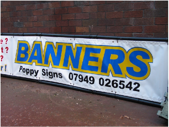

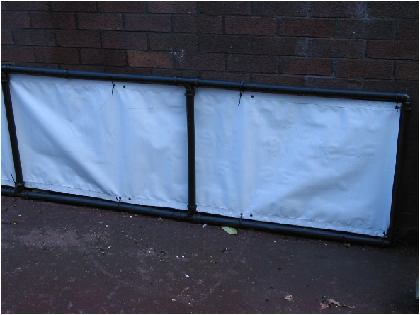

Needed a banner frame at short notice before the holiday period began, so we came up with the following.

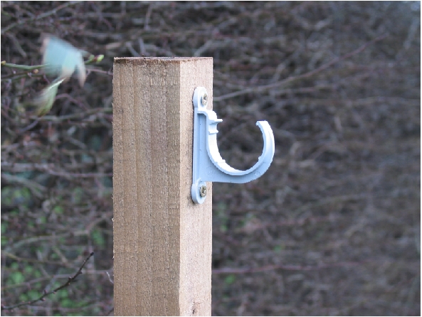

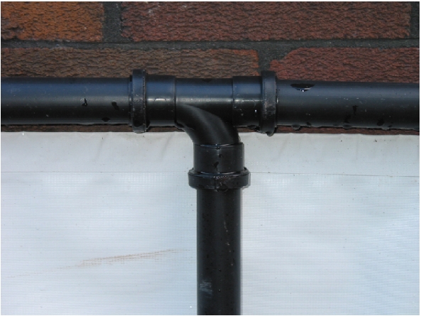

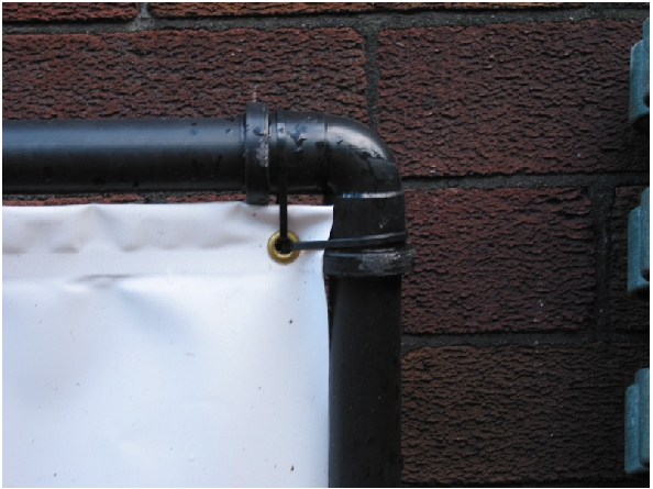

Basically, it is a 32mm push-fit plastic wastewater pipe with appropriate T and 90-degree pieces to form the frame. You get it from B&Q and all the other DIY stores. You get it in black, white and grey. It takes seconds to cut and assemble. You could use the traditional type that you join with glue – I guess this would make it more rigid but it would take slightly longer to make up.
