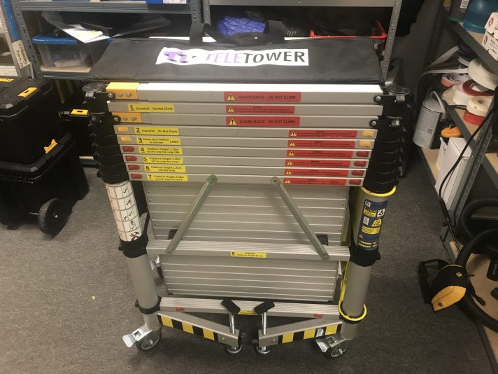

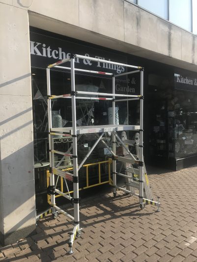

Hi Jamie
Apologies for the very late response to this thread, i hope you have it sorted now, but if not then let me give you my honest opinion.
I love it, for many different reasons, mainly 1 man assembly, will fit in an estate car or small van, its ridiculously mobile and worth every penny i paid.
Platform height of just over 2 mtrs so can easy reach 4 mtrs unless you are decidedly short.
easily goes in lifts and other small spaces, which is a bonus if you are working in large buildings and shopping centres. When you first get it, it does feel a bit weird, and kind of unstable, but trust me, its rock solid on the ground. Little outriggers keep it planted.
Picture attached for reference, but if your serious, then go for it (If you haven’t already 🙂 )
Good luck 👍
