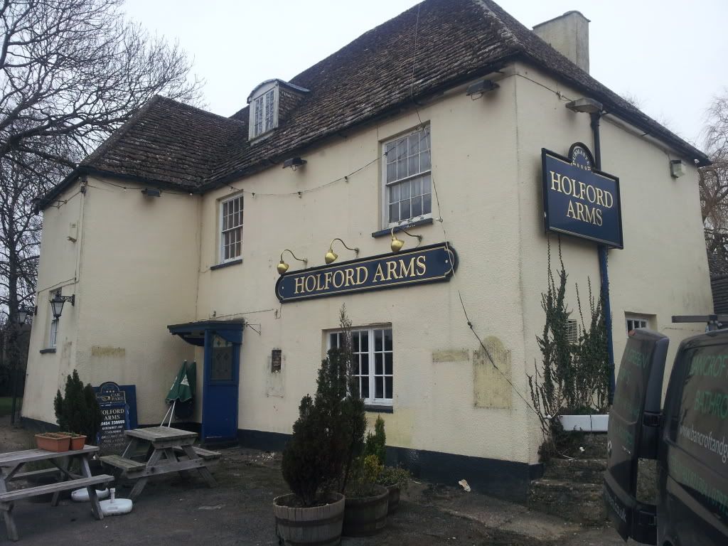

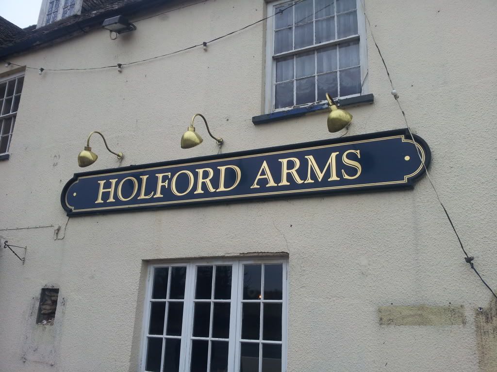

    A friend of mine has taken over a local pub and asked me to help with the re brand. This involves designing the logo(almost done) and sorting the 2 signs on the building out.
    I have looked at the signs and they are in pretty good nick so we will use these(1 wood, 1 is metal).
    Basically i was thinking of paining the signs and then applying cut vinyl lettering and logo(whippet dog) and then whacking them back up.
    He mentioned lettering that is raised from the board, is this expensive to get cut out so that i can apply to the signs?
    Ideally it would be a dark green text and the dog would have to be cut as well. Timescale is bit of a bugger as he wans to open within a month?
    I have put some pics below to show you what it looks like at the moment.
    Any advice / tips would be great.

    Sorry.. prefer the original signs (except that pubmaster bit)
    always like Gold lettering on pubs

    Cheers for the comments! But what about router cut lettering?
    Edd
  • Peter Dee
    16 February 2012 at 13:29
    Ed, make up your design and get a company like this to cut out the letters and dog shape. You can apply layered vinyl graphics to the profile shape.
    http://www.trade-letters.com/
    Just send the files full size .ai for production.
    They’ll supply it all on stand off mounts plus a template for fitting.
