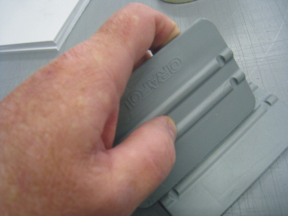

    I met up with Martin a few days ago and typically (as you would expect) the discussion went on to blokey things sign related…
    Anyway Martin admitted to me, that from time to time, he likes to rub his squeegee up against another squeegee to re-sharpen the blade in the manner shown on the attached photo. "I thought everyone did this" he said? 😕
    Well this was a new one on me, and a very welcome tip. We all know how squeegee blades quickly wear out and start scratching paintwork, well doing this re sharpens the blade making it as good as new.

    August 8, 2012 at 12:04 pm
    I did know that.
    I also know that you can rub your squeegee on a cardboard box to sharpen it.

  • Neil Davey
    August 8, 2012 at 12:14 pm
    I knew that one too – and it works.

  • Colin Crabb
    August 8, 2012 at 8:36 pm
    Tip: Be careful testing out tips from forums – A sharp squeegee can be dangerous!

  • Ian Johnston
    August 8, 2012 at 9:18 pm
    a quick rub across your leg on your Jeans or "Snickers" or the likes type trousers works the same, 😀
