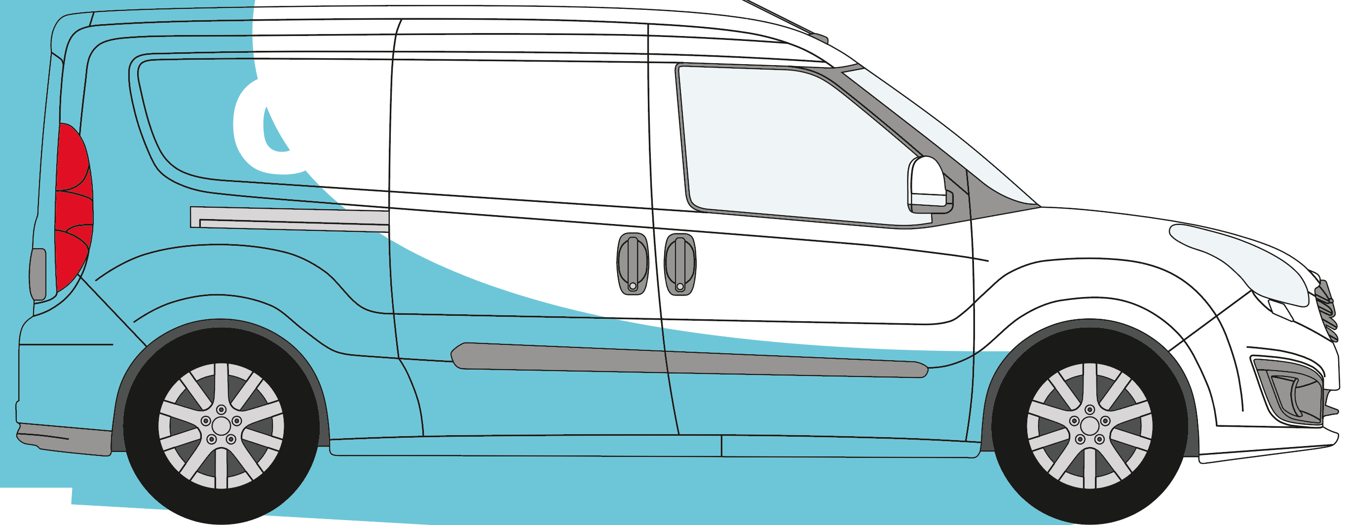

    I’m new to wrapping and i’m still very much learning how to do things correctly and efficiently.
    Please see attached image, I need to print this as it’s a colour I cannot get close to, rather than waste a large amount of vinyl, I would like to print it in sections i.e, back area, side door, front door with the joins in between the doors.
    If i use Versaworks to tile this, it will do straight lines where as I need it to curve with the door otherwise I’ll have a massive overlap, is this the correct way?
    How would you do this?

    March 24, 2017 at 5:46 pm
    I would use wrapcut / knifless tape, mark out the flowing line with the tape, print the film in sections big enough to go over the knifless and the more than the width of the panel, wrap each panel as required and thw trim using the wrapcut tape…
    Thats how I’d do it anyway!
    March 24, 2017 at 5:47 pm
    ps, just use the over-lap and trim on the edge or tuck around a few mm..
    March 24, 2017 at 5:49 pm
    Exactly as hugh says.
    Or print the curve, trim on a bench.

    March 24, 2017 at 6:03 pm
    How would you deal with the O at the top in the recess? It’s basically a border for the text to sit in
    March 24, 2017 at 7:57 pm
    I always tend to put cut vinyl over the top.
    That way it doesn’t matter if you need jocky things around as templates arent 100%
  • Simon Worrall
    March 24, 2017 at 8:04 pm
    That O will be quite distorted and probably rotated as well by the time you have got it all down, and the letter going on top is not going to fit. Just carry on the curve and fit the letters over the top as David says.
  • Daniel Evans
    March 24, 2017 at 8:31 pm
    Thanks Guys
    I think that might be the best way to go.

  • Jon Marshall
    March 27, 2017 at 12:43 pm
    You can tile it with a big overlap and then just trim that away at the door openings when fitting so you dont see any joins.
    I make the tiles in the design software rather than in the RIP
