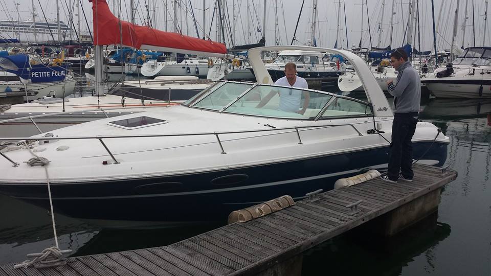

    Hi Guys
    My boat is about to come out of the water and we are going to wrap it in a digitally printed design. I will let you all know how this progresses, list any problems we encounter and add the part and complete photos….
    Here is our schedule – The design is complete – boat out this Tuesday (20th) – Measure Hull and check how the rectangle panel will sit on a curved shape – Adjust the graphic as required – Print onto Arlon DPF6000RP Wrap media and Laminate – Wait for a relatively nice day to apply.

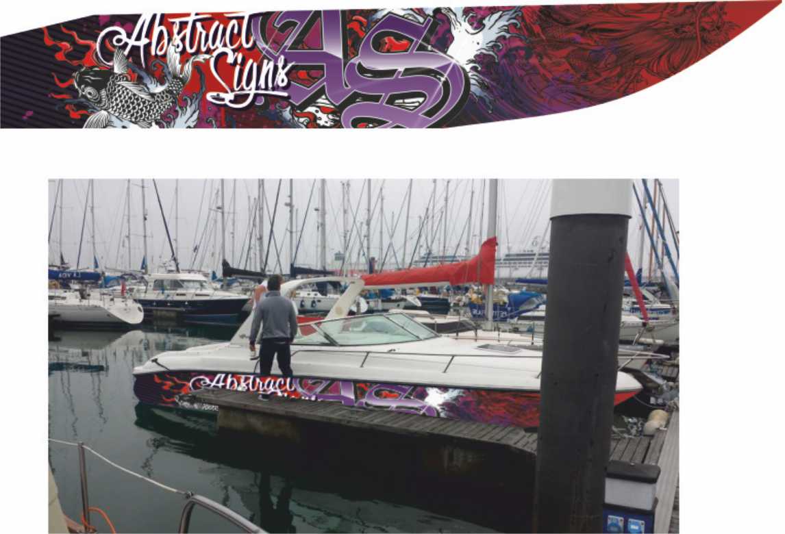

    Boat is out of the water, here is our design, hopefully the temperature increases next week as it is FREEZING here!!
  • Chris Nylan
    January 27, 2015 at 11:02 am
    Thats going to look good!! Stand out which is what you want.
    Gloss or Matt Laminate? Can imagine this would look nice with the matt lam… 😉

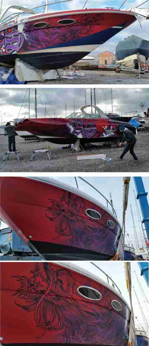

    Matt Lam, also hides the stripes that were and are on there………
    So finally finished the beast, will never do this in January again. The boat had to come out for servicing so I hoped for a relatively warm spell. Well it was freezing most days! Best we had was 6 -7 degrees. As the hull of the boat is quite thick it held the cold in and the vinyl didn’t want to adhere properly, lots of heat from our guns required. All in all it wasnt that much of a pain, some clear edge sealing tape here and there…..lets hope it stays on!!
