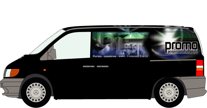

    We have just been given the attached vehicle below to wrap. The Van is currently WHITE and we need to digitally print the whole lot and wrap.
    Is there a easier way to produce this rather than print it all?
    Loads of INK!!! I do not think I have priced it right either – Its our first FULL wrap we normally do part wraps.
    Darren

    Just cover it all in black vinyl first, then apply the small section of digi print
    Simon

    I thought about that but I am concerned with matching the background black of the image as the vinyl black will be lovely and dense in colour.
    D

    You could print onto clear??, and if you contour cut the image it should not notice that much..
    What i would do, is get a bit of black, and do a small test print on clear and see what it looks like, maybe shoew the customer??
    Simon
