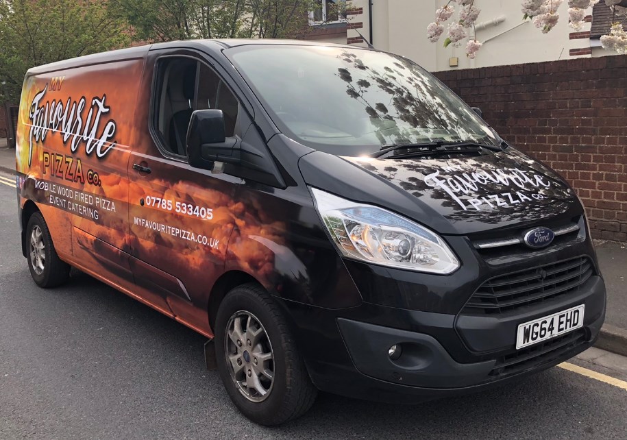

    Maybe worth looking at this as an option Dan. We wrapped this van today in a soft polymeric from Spandex. A bit grabby to fit but half the price of wrap & apparently designed for single step recesses. Seems ok so far…
