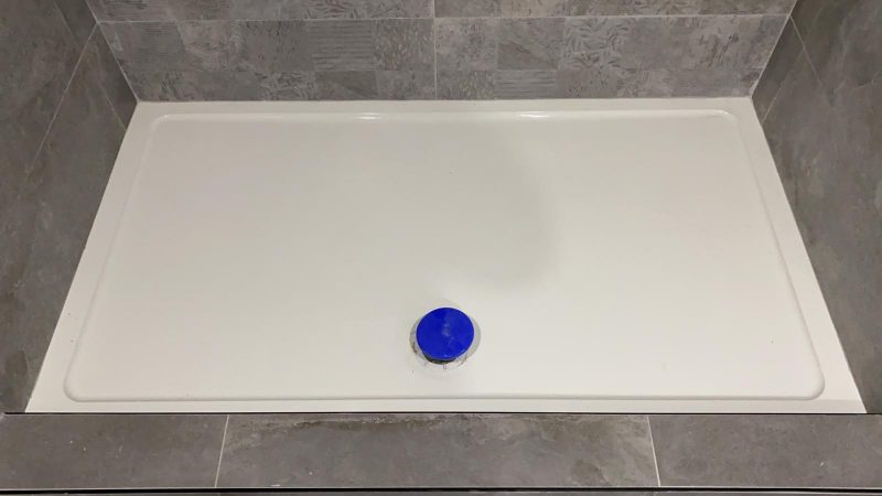

    Hi All,
    I do enjoy the occasional unusual request to make life a bit more interesting & this is certainly up there!!
    Customer has asked if I can wrap their shower tray (approx 1.6 x 0.9m) in matt black vinyl.
    It’s quite a shallow tray with maybe 10-15mm lip so think it would be very possible to heat a wrap vinyl in.
    Weak points I would think to be around the perimeter but wondering if a bead of clear silicone sort that? & the plug surround but he has said that could come out to wrap beneath before refitting it.
    Otherwise my concerns would be the obvious hot water on it regards durability & secondly slip! But having said that I don’t imagine it would be any more slippy than the original smooth glossy surface & I had thought it may be possible to add a layer of an antislip floor laminate to the bottom flat section potentially either as a solid piece or maybe make a feature of it by cutting it into circles or stripes.
    I’d be interested in anyone’s views, ideas or comments on this & certainly if anyone has done it successfully before.

    Hi myles, yes ive done this job years ago in my old cottage because the tray had split. My tray had raised knobbles all over it so cant say much about the slippyness but its an easy enough job to do, i only used a polymeric if i remember correct.
    • Myles Brewer
      23 April 2021 at 09:07
      Hi Martyn, Did you seal around the edges or anything extra like that or was it ok just trimmed to the grout line? & did you have to heat it to conform or did you cut the corners as it was polymeric?
      • Martyn
        23 April 2021 at 17:17
        No mine was a deep tray and i just covered the lowest part not up the sides. But yes in this case i would seal around the edges. Mine was just a blag/quick fix because the shower tray had the tiling straight on top so it would mean renovating the whole shower to remove the tray. It did its job for 5 yrs then the new owner renovated.

    I’ve never done a shower tray but have got umpteen bath panels behind me. Always a yellowish white & always got loads of mastic on them. A metre of matt black wrap is going to cost around £25-30? I wouldn’t settle for less than that if I was doing it Myles, hot water & detergent is never going to extend the life of the vinyl whatever you use but you don’t really want to be called back to somebody’s shower cubicle to replace it if it fails.
    I doubt the usefulness of the anti slip lam to be honest unless they shower with their shoes on. Wouldn’t think a bead of sealant would do any harm though
