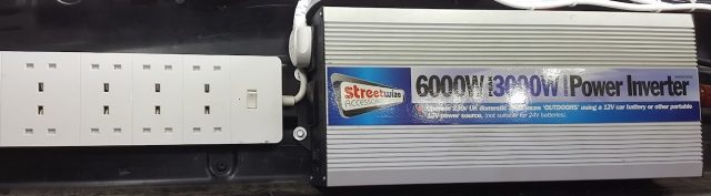

    January 24, 2022 at 9:21 am
    This is the power Inverter I have in my van to run heat guns from.
