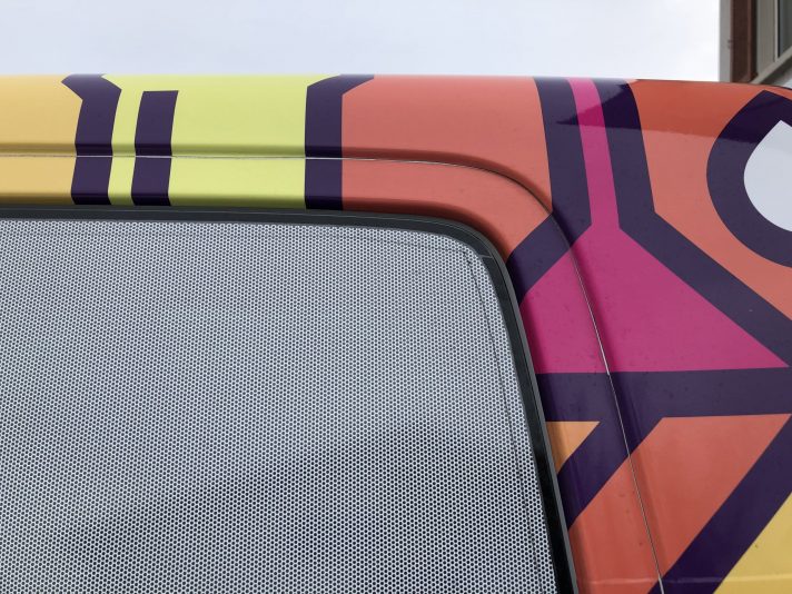

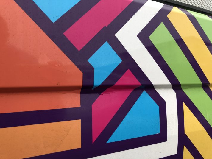

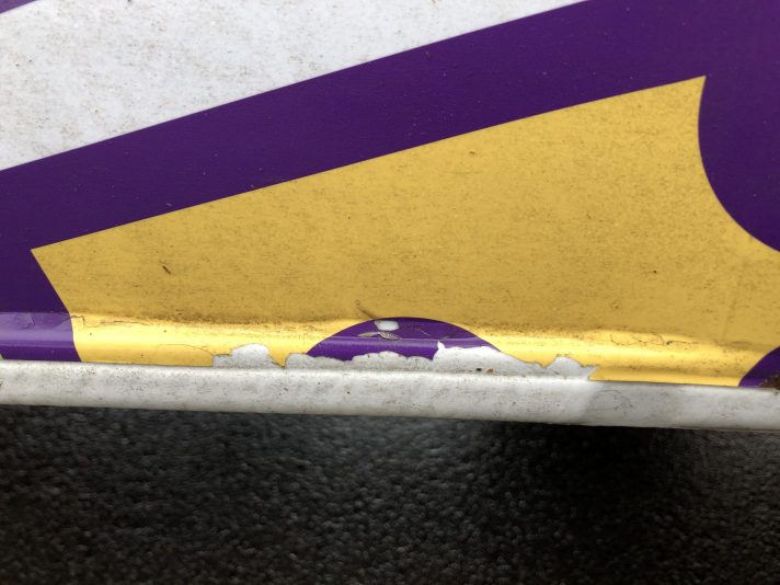

    Good evening all,
    As per title, Will this Metamark MD5A wrap fail? And how to avoid / fix fail?
    This is my personal vehicle and I didn’t want to waste my Arlon SLX roll.
    I can see the vinyl popping out on a light recess just after few hours.
    Any suggestions welcomed.

    if it’s already pulling out then I guess that’s a fair indicator.
    Metamark MDX would’ve done it, not a whole lot more than the MD5A,

    June 20, 2019 at 10:07 pm
    Please take my comments constructively…
    Metamark MD5 is the wrong vinyl choice for this job. i.e. It is Not a Wrapping Vinyl.
    However, I would have to say that in those locations showing the fail, "the application method is wrong".
    I say that for two reasons…
    1, the vinyl, although the wrong choice. would cope with such a shallow gradual recess.
    2, the vinyl should not be pulling back, as the vinyl really should have been fed in and out/over the recess rather than stretched into, which in turn causes the pullback as it shrinks under tension or because it is a calendered film.
    With regards of how to avoid this fail as in your title? My reply kind of explains that… use the correct tool for the job with the correct application method.
    Sorry, I know this sounds a bit brutal, but I hope it will save you time and money in future, as well as others reading.
    hope this helps mate…

    June 20, 2019 at 11:01 pm
    If you’ve a straight eye you could run a scaple down the recess. You need to be careful not to destroy your paint though. That way rather than pop out your vinyl will shrink slightly leaving a thin white line. At least this way it won’t split open over time.

    Good morning all and thank you for your comments so far. Perhaps I should have asked the question different.
    In my workshop I only stock MD3, MD5 and Arlon SLX. Wrapping always with SLX.
    I agree with you MD5 is not the vinyl to be used for this project.
    Being my personal vehicle I did this job as a test and to spend my remaining roll of MD5A. T6 is pretty flat van an the application was smooth. At a moment where vinyl is lifting and starts to look bad-I can remove wrap that very same day when noticed.
    I have only 2 sides printed. I will do other side today.
    I’m not wrapping the bumpers.
    I will wrap the back with Arlon SLX.
    I will do a cut line as @David Stevenson suggests and hope that I will get 3 years from this wrap.

    Honestly, I thought, ok its small recess, let’s try MD5.
    Second day and I don’t see this lasting as it is popping out on all small recess.

    November 24, 2020 at 8:02 pm

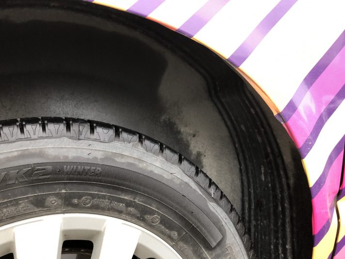

    I would like to update you on this one.
    Although I was hoping this will take me trough my lease, it didn’t.
    I had the van serviced at VW this week and they washed it with a strong jet. In the big recess where the MD5A popped out after few days, the strong jet teared the vinyl. (Also cold this week, around 0 degrees, so vinyl is brutal, hence the cracks)
    I dont have close up photo, but imagine that all deep recess failed and are cracked at the moment and chunks of vinyl are missing.
    So lesson learned. Will get re-wrapped soon in Metamark MDC. (Testing the MDC for the first time)

    It is nice no to be able to visit the forum because of too much work. In the past 2 weeks has been crazy. Went on install today, van was waxed, so I came back home. Day off work.
    Some of the fails are due to my mistake. I did not feed the vinyl properly. I was treating it as cast and used heat to push vinyl in. Some is due to the ability of MD5A.
