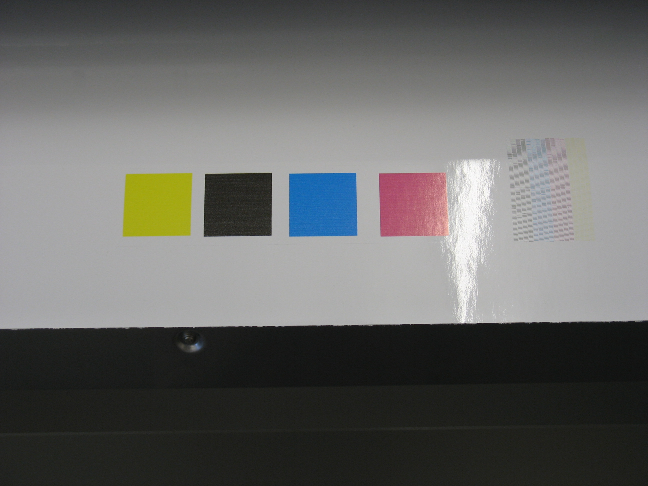

    hope you can see the problem on the attached
    pics arent too good but hope you can see the problem
    by the way what would be the best way to photograph these to show
    i am using canon a610

    cant see the pics well enough Derek but am guessing there are small splodge marks on the black print?

    Do a "test print" (on control panel) and post that so we can see the problem

    here is the test print also some 30mm boxes cmyk
    if you can get in close you may see the problem
    cheers

    Your test prints look ok.
    Can you just change the artwork over to RGB, I’m sure signlabs normally works in RGB so maybe that’s the problem.

    your test prints show a bad set of jets some are deflected they should be evenly placed lots of cleaning to do. are the pumps working correctly

    thanks Steve just ran the same test in rgb still have the slight banding
    but the black is much better when i was trying to set it at rgb unless i altered the slides a bit it would just revert back to cmyk

    it makes colours by putting another colour on top of another if the jets are not in alignment how can it do this plus how can it fill in the passes if a lot of jets are deflecting away fron where the ink should go.
    a really good cleaning job normally sorts it but it may be showing signs of pump problems.

    The black does look like it’s got a lot of deflections all in the same areas, this won’t help with banding but I thought your problem was with the colours looking washed out not banding.

    the black is much better in rgb other colours are improved but still have the lines running through might be time to get the engineer to get it all even
    it hasn’t been run that much since new maybe that’s the problem now needs its 500 mile service been cleaned regular and the test print everyday

    I’m with Chris on this one.
    I’d suggest you have a pump problem personally.
    Certainly blocked jets, which could be caused by the caps being blocked and not draining waste away well enough,
