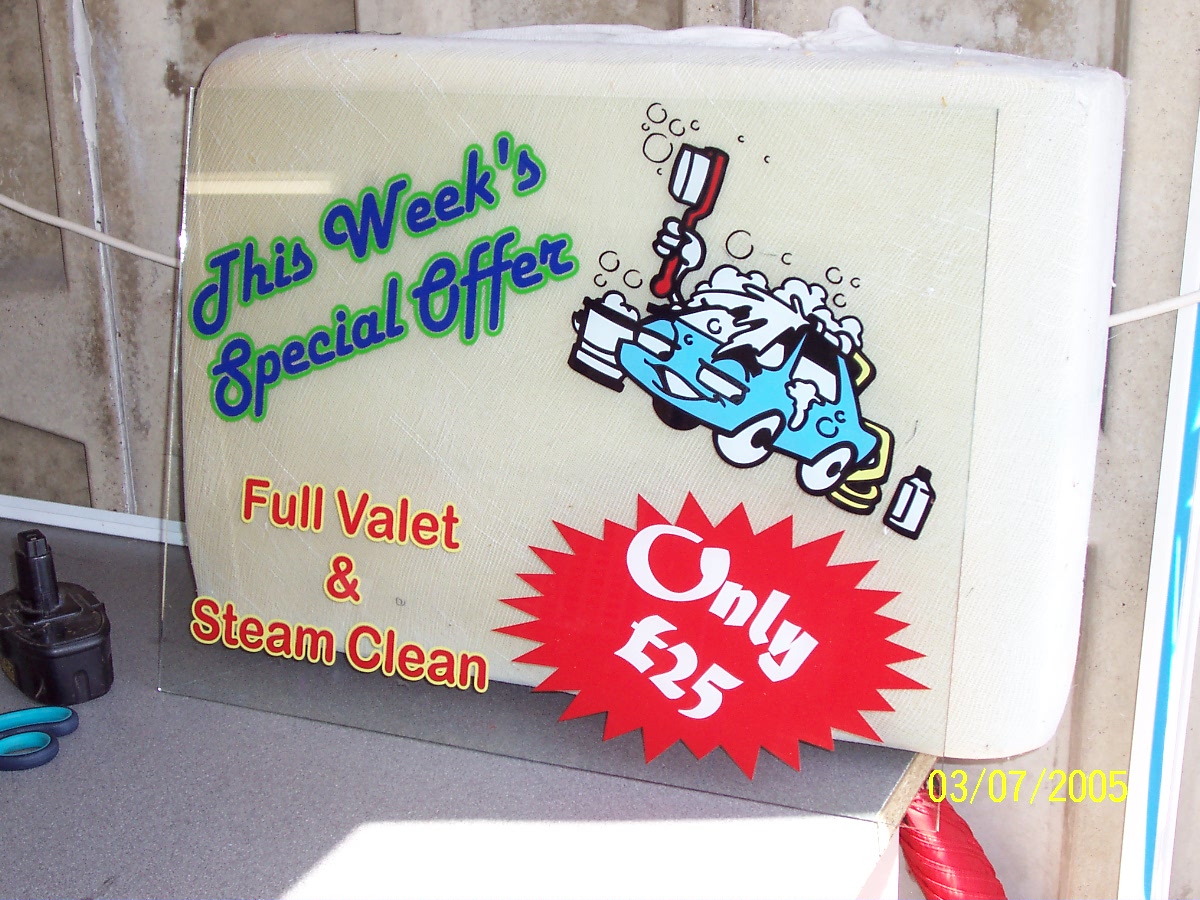

    I layer up on the job and do it dry..
    Instead of squares and circles for reg marks i use a series of 4mm dots around the layer. on a 60×60 i would use maybe 5 or 6 along each edge. Tape up the layers as normal. Lay down your first layer as normal. Next use a tailors punch (looks like a pair of pliers with a rotating wheel at the end) and punch out all the dots on the remaining layers. This gives you accurate registration marks all round your graphic. All you have to do is allign the holes to the dots on your base layer. When you are finished remove the dots from around the graphic.
    The atatched file was done using this procedure.(the car)..It sounds long winded but after you’ve done a few it is a fairly simple idea
    Hope this helps
