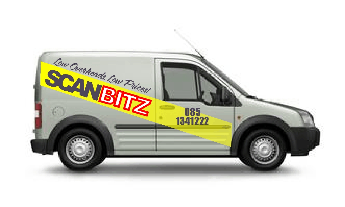

    Having very little experience applying vinyl Im wondering do any of you see major problems applying the yellow stripe or have any tips. What vinyl would you use and would you use heat etc? Just a bit nervous about it. I posted the pic of the van so you could see the contours better. Thanks for your help, once again.

    Hi Harry the only problems I can see are the door Handel, key lock and rubbing strip you can cut round the handle and lock, but I think you may find you can’t go over the rubbing strip, they are sometimes treated with stuff that doesn’t like vinyl, but you can always fit up to it and chop it out, it won’t really detract from the overall view, another thing I would say is I really don’t like the text above the stripe on a slant it would look better straight. you may need a bit of heat where it goes over the ridges on the door. You may have to change your thinking for the other side 🙄
  • Harry Cleary
    27 February 2007 at 22:40
    Thanks for that Lynn, I see what you mean about the slanting text, I have tried to talk the customer out of it. It looks much better on the other side as it goes up with the slant, it was the side I showed him first, which was a mistake 🙁

    Harry, I’d use a cast material to be safe. Otherwise, I don’t think it will be as hard as it looks initially.
    Be conscious that if you start from one end, with little experience, you may find yourself ‘dipping in the centre. I’d start from the centre and move back to the ends, if that makes any sense. Lowers the chance of a mistake.
  • Harry Cleary
    28 February 2007 at 11:11
    Thanks Shane, just ordering cast now, I’d value your opinion on the slanted text that Lynn mentioned, is it gonna look awful or is there a way to make it look better?
    28 February 2007 at 11:31
    the only thing I’d change is to have the text ‘low overheads etc’ on the one line. It will sit above the yellow nicely, and being in one line, will not seem so out of place as it does now. The higher the lines sit away from the yellow, the more obviously ‘wrong’ it becomes. I guess its a gravity thing
    Other than that, I can’t see any other way around it to me honest. 😛

    Just thinking Harry. Are you sure the white is going to stand out on the yellow? Perhaps its a melon yellow or something? or are you doing a fine black key line around the white?
    Sorry mate, just thinking ‘out loud’ 😳
  • Harry Cleary
    28 February 2007 at 11:49

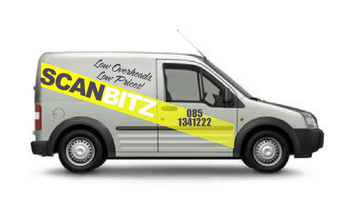

    Hi Shane, I think you have cracked it with the text on one line! thanks mate, I feel much better about it now, The white was always gonna have a red outline, just forgot to include it.
    sorry dont know what happened the colour
    28 February 2007 at 21:17
    Thanks mate, I think that looks much better too.
    28 February 2007 at 21:37
    yes Harry that looks a lot better as for vinyl I would probably use oracle 751 or mac 9800 there are no serious groove’s so should be fine, sorry see you have just ordered cast 😳 that will be fine as well.

    Doesn’t look to bad Harry, but I would not cut the yellow band off with a straight edge as you have by the door, I would just continue it all the way to the wheel arch. I would also run it right across the back as well so it went up one side of the van, across the back and down the other side. Its not a difficult job with a van like this as its mostly flat. still think the text above the yellow band would look better on two lines and straight as Lynn suggested but everyone has their own opinions on these things. As Lynn has said the bump strips can sometimes be awkward to get the vinyl to stick to but if its cleaned properly and you apply a bit of heat once it is fitted it should be OK, I normally cut the vinyl where the bump strip is fitted at the top and the bottom that way if it does start to come off the bump strip then the rest is still perfect. The bottom of the doors is almost sort of like a corrugated finish rather than recesses and I would be inclined to fit the vinyl to the shape of these rather than fit across the high points and then try to stretch the vinyl into place.
