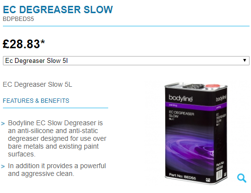

    We used to use this one
    ec-degreaser but found it is too slow to evaporate off for us (they used to do a fast version 🙁 )

  • Andy Thorne
    October 11, 2018 at 8:14 am
    We are mainly a trade supplier of metal products to the trade. We use it on raw aluminium to remove grease etc prior to applying double sided tape but often use as a cleaner on powder coated and painted surfaces when meths won’t do (although make sure the paint is fully cured or it will soften the paint and take a touch off of that too!). I know some of our customers use for degreasing panels prior to vinyling though. If your powder coated panels are coated in an architectural grade powder coat (which ours are) these have a waxy film to the finished surface designed to repel water and keep the product looking clean. What this also does it make it difficult for vinyl to stick to it! This degreaser also takes that waxy film off. Probably not what your necessarily after it for but thought i would throw it into the mix anyway!

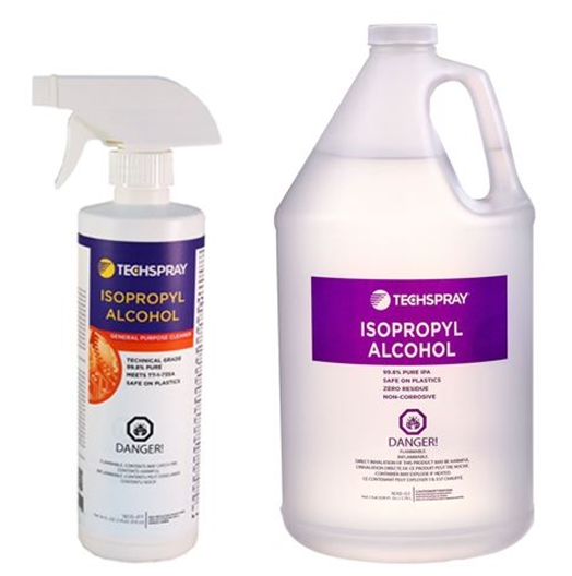

    3. Final clean with Isopropyl alcohol using microfibre cloths, just before application of vinyl.

    October 11, 2018 at 9:26 pm
    This, like many topics regarding vinyl for "me" is a bit too deep for me to get into by text. :smiles:
    anyway, in short… I use the following for cleaning panels. and yes i do know the manufacturers recommendations and abide by when i feel necessary…. This is just what i use for day to day use.
    For the record: NOT BRAND SPECIFIC

    4. IPA
