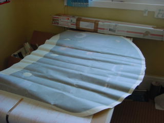

    We have been asked to fit some graphics by another sign company however the the graphics were imho not very well packaged and arrived quite badly creased (see pictures)
    Do we go ahead and fit them or do we get some new ones sent.

    And another
    as you can see it’s a full colour print

    Had the very same thing yesterday. An interstate supplier sent me a sign that had to be fitted next day. It looked the same as your photos. I had to try something, so I applied it wet and although the fitting was slow, I overcame most of the problems.
    With the one or two creases I had left, I hit them with a hot air gun, and they pulled tighter and looked much better.
    I don’t know where they are going, but if it is outside, the heat will probably pull it more tighter over time.
    I’d certainly explain what happened thoe, and explain that you will do you best to fix it. They are going to be discarded anyway, so it may be worth a shot. Cover yourself with glory if it works, or if it doesn’t work, at least you showed the supplier you were prepared to give it a go.

    They shouldn’t be sending anything in paper tape.
    Absorbs water, with capillary effect, expands and contracts too much with the humidity and temperature leaving you with a creased delivery, clear plastic is the way to go for posted stuff, but its more expensive, hence the reason for leaving you with the headache.
    But you’ll probably find that the clear plastic carrier would actually lift the print off the vinyl, hence the paper trash*
    Would have been more professional to have sent the graphics unattached and asked you to *lay* your own application/transfer sheet when and as needed.
    * nothing wrong with paper transfer/application sheet, I prefer paper and find plastic doesn’t have the needed ‘give’ in it to aid a successful large(ish) installation, depends what you know and I of course know nowt.

    I would also arrive with the job and show the customer, let him decided if you should go ahead.
    Tell him upfront that the vinyl is kinked and creased in places, giving a very slim chance of an acceptable application.
    I have applied creased vinyl before, its possible with two people top get it perfectly flat and bubble free, BUT… there is always lines in the vinyl, these are impossible to get rid of once applied.
    The only possible way of ridding the vinyl of a kink or crease is to remove the application tape, then remove the vinyl from the carrying paper.
    Then (if you have them) get 2 guys to hold the vinyl out straight/flat, but NOT tight. Then, take a heat gun and gently “always moving sided to side” hover the creases with the gun. You will see the creases disappear.
    Make sure the guys aren’t pulling, because once the heat hits the vinyl it will distort and cool that way. Making applying very difficult.
    once you have rid the creases, apply with a felt squeegee.
    If however you have loads of creases in a large piece you may distort the vinyl too much be heating at numerous spots, causing it to distort

    The graphic wes sent rolled up on is self with an elastic band around it.
    At some point in transit it had been squashed flat and then folded causing those tell tell creases.

    the reason for applying app tape to a full print is that it can be a nightmare to apply otherwise. Solvents and ecosolvents tend to thin or attack the vinyl and dark areas are attacked more , polymeric or cast vinyl is generally pretty thin as it is and if you dont use app tape , once the print is taken off the backing it tends to selectively pucker etc. The app tape also protects the print when applying.
    You need the right tape tho , low tack paper based is the way to go as it allows solvents to evaporate and doesnt damage the print itself when removed.
    We send large prints out in cores generally and multiple flat prints like certificates are packed tween plywood or some other rigid substrate.
