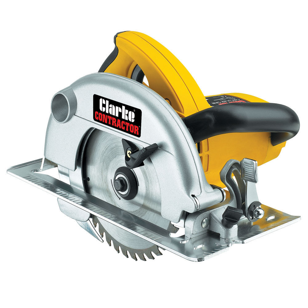

    I have used to use festool circular saw with a special blade and a runner – this was years ago while working for someone else and I can’t remember what exact blade we have been using…grr

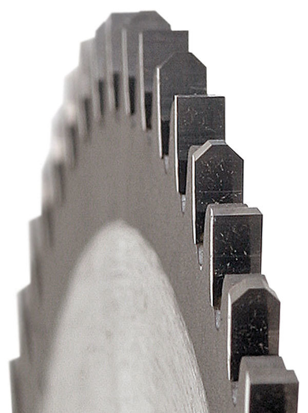

    You can buy a blade for the saw and it’s always a high tooth count and it’s specifically for acrylics and ACM I think. It’s been a long time since we’ve needed one but I’m sure they were about £110 and 96toothcount.
    December 29, 2016 at 8:48 pm
    For acrylic & composite you really need something with a negative rake blade, it will have a high tooth count & they tend to be more expensive than most other blades 😆 😆

    We use a wall saw, festool, cnc router or even jigsaw. just depends what your cutting, size and finish required.
    a standard ripsaw with an acrylic cutting blade will do the job to cut sheets etc, but it is important to keep the acrylic totally flat and minimise any vibration with G-clamps / trigger-clamp etc.

    We use a triple chip saw blade in our table saw and panel saw.

    Thank you all – I think we will get Festool and special blade or try to find a blade to fit our saw… we only need to cut square and rectangular panels (various sizes) we can do shapes using our small router (only 600x1200mm) or jigsaw (using special bosh blade with pleasing results)…
