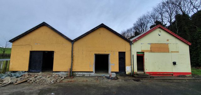

    Hi, We’ve been asked to quote for a job regarding fitting a large mural to the front of a building. The building in the centre is to be covered completely with the others on the left & right covered at the upper part where the pitch is. Can anyone offer any ideas as to the best way to do this? There’s been suggestions of putting on batons and screwing / gluing dibond sheets to these, getting huge banners made and fitting them, or having the whole front plastered and applying a vinyl like Roughmark. Just trying to get our heads round which would be best. Any advice very much appreciated.

    Is this a plastered brick wall David?

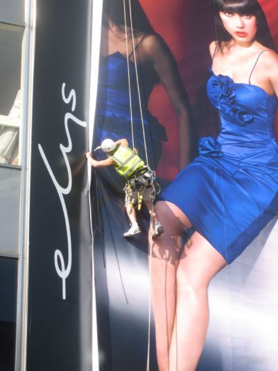

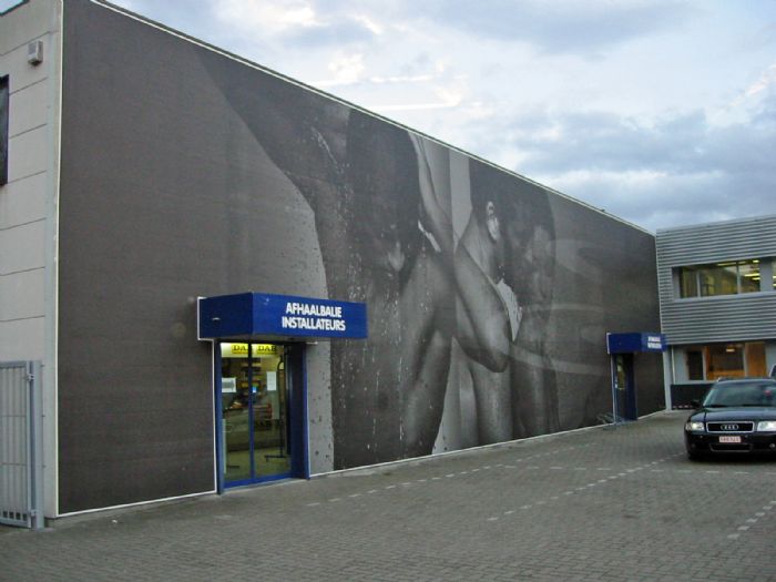

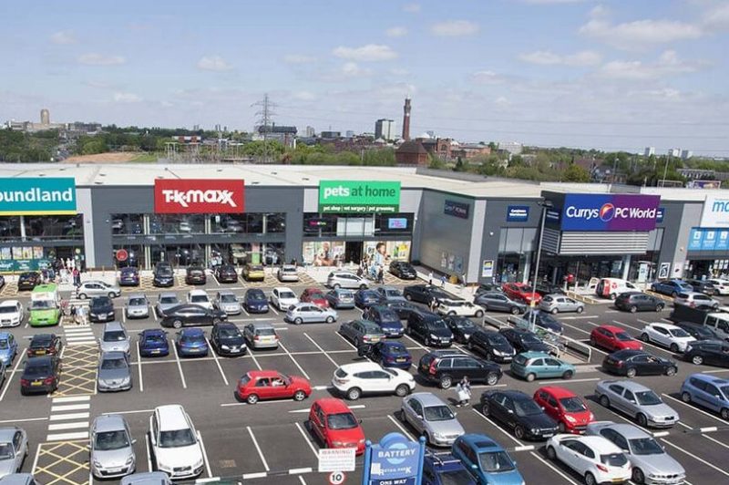

    If the wall is sound enough, i would consider using one of the banner tension extrusions from spirit-flex. I have used their stuff periodically over the years on certain jobs. a couple being similar type thing you have shown.
    basically its an aluminium channel that you screw around the perimetre of the building or sign, truck or whatever. then fit banner by chapping in a plastic face clip the full peritmetre.
    You can see in one of the pictures, a similar type building done, as you are looking to do.
    This guy in the video makes it look harder than it actually is. 😀

      While the plaster is flaking a bit in places the wall behind it’s super solid. Tried hammering a masonry nail into it and bent the nail!!! That banner system looks a good job. The building doors are changing slightly from what they are now but I can see that working nicely. Thanks

    25 February 2021 at 11:09

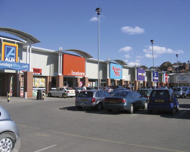

    Within retail parks, the majority of the signs are flexi-face tensioned banner systems.
