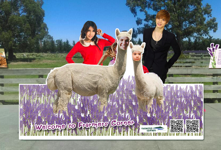

    Hi
    I have been asked to design and quote something like this for a local tourist attraction.
    It will be for kids to put their faces through the holes and pose for pictures with alpacas in the background.
    The structure will be about 4 or 5 feet high, and will remain outside for some years in the full force of the wind and rain – and it gets pretty windy round the south island quite often.
    I imagine it will be bolted into the concrete paving and have some sort of structure to hold it together.
    What materials would the forum recommend I use for this?
    Thanks in advance.
    Simon.

    We have made several of this type…metal frame 20/20mm and PVC 10 mm face structure CNC cut ,and PVC vynil laminated. Hope I have helped…
