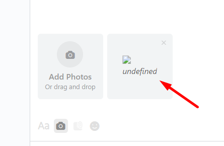

    I can’t see anything in the picture you have attached, Simon. Could you re-upload it mate, it might be you have selected “file” upload and not “photo” upload.
    Is the old picture still behind the glass or have you removed it?
    February 22, 2023 at 1:04 am
    I have just checked, and you have selected the photo upload properly, but the “file type” is unidentified.
    • Simon Worrall
      February 23, 2023 at 2:20 am
      I dont know what happened there Rob, I didnt intend to upload a photo at all! Must be fumbling fingers.

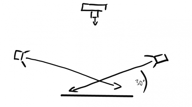

    Camera perpendicular to art work, with lights on either side, pointing towards the opposite side of the work. If possible, flag the lights from the camera and lens.
    If the camera is reflecting in the glass, shift it off axis. If you put a grid matt down where the work would be, and take a picture with the set up off axis, then it is simple to undistort the picture in Photoshop, and apply the same transformation to pictures of the photos.
    Use the DSLR and the tripod.

    February 23, 2023 at 2:22 am
    Thanks Richard, for that diagram. That makes sense. I have a pair of work lights I can use.
