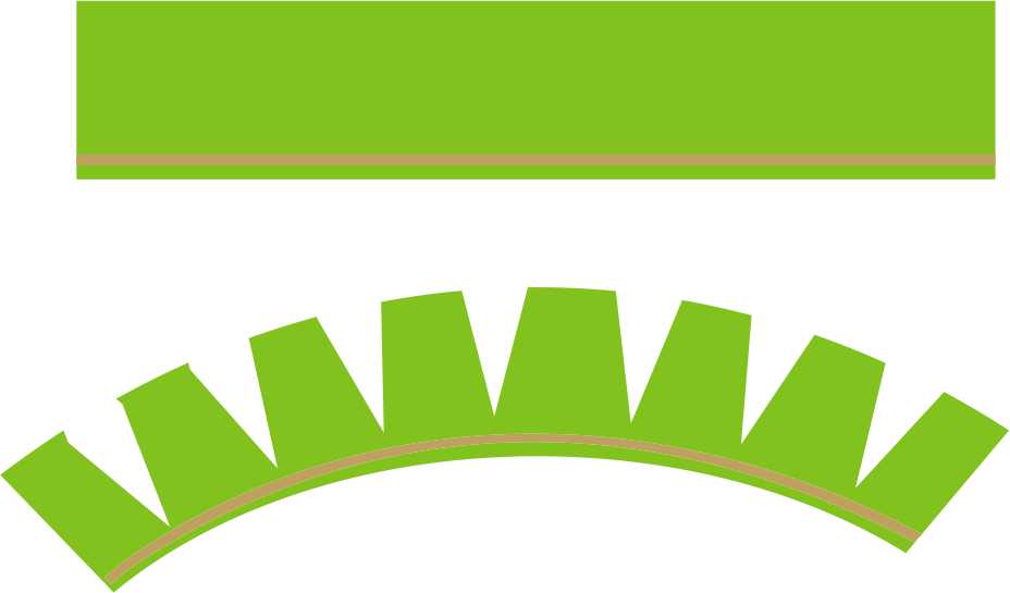

    Some cutting tapes have the filament at the edge, if you use those you can snip the carrier tape at the corners to allow for a tighter bend. Don’t overdo it though. Always give it some heat to give a better bond
