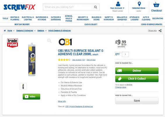

    Hi Leigh, we use OB1 from screwfix. What’s possibly happening is your current glue has no flex in it and when the heat hits things start to expand and contract causing it to fail. This adhesive stays flexible which should cover you for the movement you’re experiencing.
    https://www.screwfix.com

    top stuff
    thanks for your help, my guess to the cause of the failure was exactly what you said, just could not think of a way to stop the issue
    ill give this adhesive a try and fingers crossed

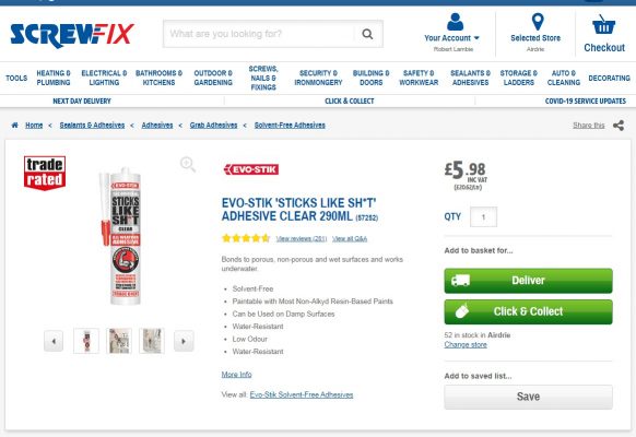

    Big fan of using this for any of our repairs to (supplied) tray inserts that fall out
    The biggest issue with bare aluminium is surface cleanliness.

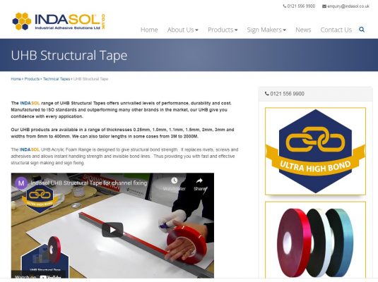

    We use a UHB D/S tape from Indasol with primer and silicone around after, works a treat and have been doing it this way for many a year!
    https://www.indasol.co.uk
