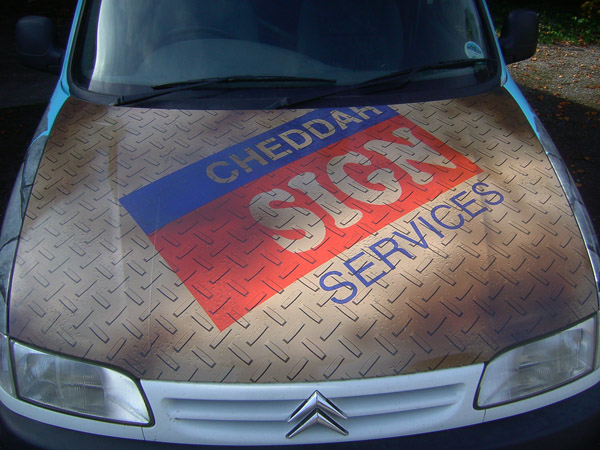

    After attending a wrap course at Spandex in Bristol I thought the thing to do to practice would be my own van.
    I came across plenty of problems on the way which will help with the pricing and pointing customers in the right direction.
    I also learned alot about artwork, materials and different processes.
    The keen eyed amongst you will spot some flaws which I will be happy to discuss.

    Design is a bit busy, it bugs me that the hood (bonnet?) is different. I would have liked to see that stone wall curve across it with a Killroy looking over it.
    The logo itself is rather lost. Would like to see SIGN a bit bigger on it, too.

    I thought about having the wall continuing over the bonnet but getting it to line up may have been an issue and also a flat wall didn’t look correct. The idea behind the bonnet was to attract the younger customer who may want their bonnet wrapped

    I think the bonnet could have been a bit brighter as it doesn’t fit in with the rest of the van.

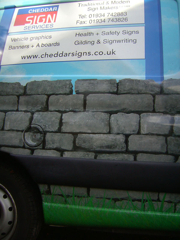

    I Like the wall, the grass and the sky as a backdrop but Don’t like the sign board idea. You’ve wasted so much available space. That word Sign must be 2" tall when it could have been 12". Sorry to be critical but thats why you posted yes ?. That word signs needs to be the prominant word on the van.

    Like the concept lots, The bonnet and top side panels are lost though. The Address sign on the doors is fantastic against the stone work. The panel sign you used for the upper panel and rear practically wipes out the information contained on it.

    The bonnet does let the whole scheme down though, change that and it should look ‘different’.

    If you toyed with bringing that sign panel on the side of the van from behind the stone wall to the front of the stone wall maybe all the info could have been bigger by making the sign board bigger?

    Now that i’ve done it and had chance to stand back I have spotted many of the design flaws. I’ve already looked at how to make the name on the side larger, I can see that the details are fine on the back where someone following can read it bu almost pointless if they are taking up space on the side where the name should be larger. Does anyone think that doing that with cut vinyl over the top of the wrap will look ok or terrible
    I did originally continue the bonnet design over the grill but as the grill slats are quite deep I struggle to cover all of the white and it looked terrible, when I re-do the bonnet I will print some extra to cover the recess’s in the grill.
