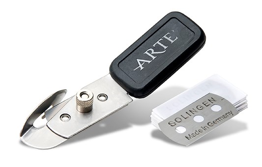

    Various methods to trim paper Shaun, from doing it by hand through to the likes of an automated Fotoba machine. I use a desktop keencut type cutter, but a descent straight edge will do if its not something your doing a lot of.
    Overlap depends on you or who is fitting it and preferences. Some folk will overlap, some overlap and cut to create a butt-join.
    Butt-joins can be doing using a straight edge and scalpel or purpose made knifes like the Muraspec double cut knife.
