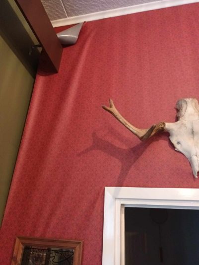

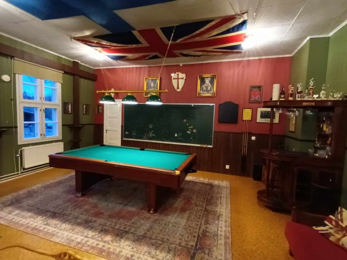

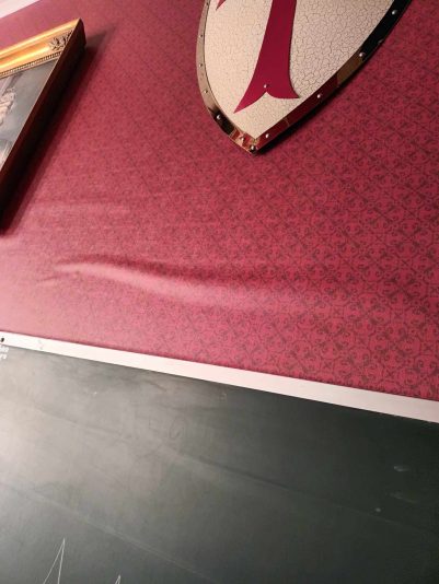

    So, let me take you back to april, spring. I had a rare slow day and come late morning i decided to wallpaper my man cave, a job i had been waiting to do for almost a year so i print it all and fit it in the same day.

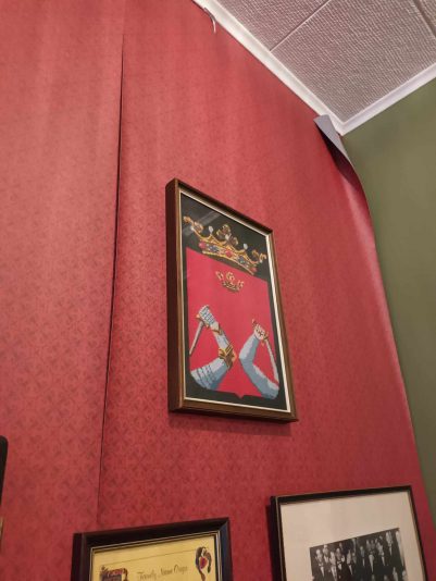

    Over the next 4 to 6 weeks i notice the outside edges starting to curl. I squeegee them down and hope for the best. This continues for a few months to the point now i have left it and as you can see its just got worse. Now having spent the last few months self harming i have now come to terms with having to sort this out but im really undecided on the cause of the problem.
    Initially i thought that having trimmed the drops out within 30 mins or so and fitted them straight away that this was the problem. ( I have done half a dozen jobs for customers and always leave 12hrs)
    but there are other things going on here that confuse me. The wallpaper was fitted flush to the wall edge and now you can see a 5mm gap. Its not just the edges which have problems, there are creases lumps and bubbles all over, even the overlap edges have come away.

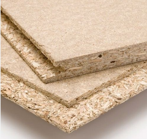

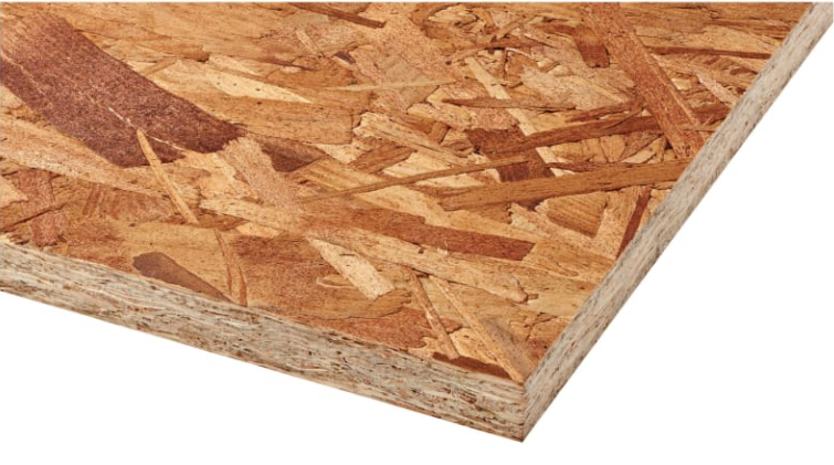

    The paint and substrate of the wall – 5mm chipboard that was painted a few years ago with paint that has a high VOC of 30.
    And humidity- Being chipboard it does expand and shrink with the seasons. Our house goes from 10% in winter to 60% in summer.
    Also being chipboard from the 50s apparently there is some sort of smell/toxings that these older materials let off, could this be the problem.

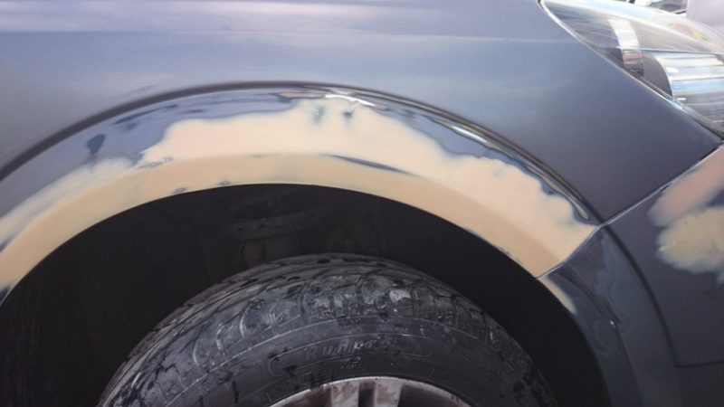

    I do not say that just for walls, I mean this with any vinyl. Nothing bugs me more than to see so-called wrap tutors or well-known wrappers in the industry wrapping a paint-primed wing of a car. Not rough, but perfectly smooth sanded cataloyed damage repair. It will look good for 5 minutes, but will not last long term and certainly won’t allow optimal bonding of the best of wrapping films. The fact it has a matt finish is a reduction in the bond, right away.
    OK, so your wall being a chipboard sheeting material is pretty much the cause for the failure.
    I can see a decent-sized radiator in the room. And you have also mentioned the big changes that can occur with regard to room temperature. If behind the wood is a cold stone wall or a cavity where air moisture can get in. The sheet will expand and contract with the room temperature, “minimal” but still.
    The vinyl will also do the same, the difference being the vinyl will tighten up over time, whereas the sheet will continue to move. What is happening here is a bit like a Snake shedding its skin!
    The tell-tale signs of this are not so much the vinyl curling off the wall around the perimeter, but the loose wavy sections in the middle.
    To make matters worse, the rough micro-texture surface reduces the bond much more. Now throw in a matt emulsion paint or similar, and the vinyl really doesn’t have a chance to properly bond, never mind long term.

    This isn’t going to be perfect, but it will give you a quick fix and tidy the wall up for only a few pounds for the tape and 30 minutes of your time. The outcome of this will be greatly determined by the shrinkage or tension in the vinyl, which I can already see around the photos.

      Thanks rob. Yes the room is well heated, a constant 18c really. The wall is actually an internal wall with heated rooms behind. So i think we are all in agreement that me cutting the prints too soon is not the cause 😅.
      You metioned some good options to solve this but for once i think i am going to accept defeat. Strip it all off and continue with the red painted wall. I’m far from happy with this option as it takes a lot away from the room but i think cladding the wall in dibond is the only option and an option which i cant be arsed to do. Too many things to cut around for my liking and to get it butt perfect is unlikely.
      I guess if i was going to have another go, stripping off, PVA the wall and go again would be my next step but i dont believe this is 100% as we still have the board and movement issue.
      Maybe i will cover the wall in more memorabilia so theres not much wall left to see 🤔
      I suppose its another lesson to be learnt. I agree with the matte finish and gloss is going to add so much more of a surface but i rarely see a gloss wall. I have applied to plasterboard and rendered brick and had no problems in the past but now i know to walk away from chipboard!
