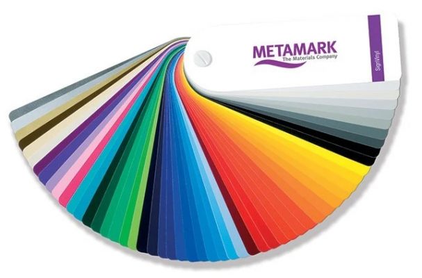

    I have done a lot of work for galleries in the past 20 years. The following situation always confuses me, as wall graphics come back and bite me from time to time.
    Metamark M7 vinyl is the vinyl in question.
    Normally for this gallery, I do white and black matt.
    This sticks ok’ish for the purpose of a couple of months as the length of the exhibition… and the client is happy for many years. This time specs change.
    The colour that the client wants does not come in MATT, so I laminate the same Metamark M7-184 Mauve gloss with a MATT laminate for MD5.
    I sent the vinyl to the client.
    The client applies the vinyl.
    Vinyl is peeling off the next day.
    What changed?

    M7-111M = matt black
    What did you laminate the M7 with?

      Mauve M7-184 was laminated with MATT laminate for MD5.
