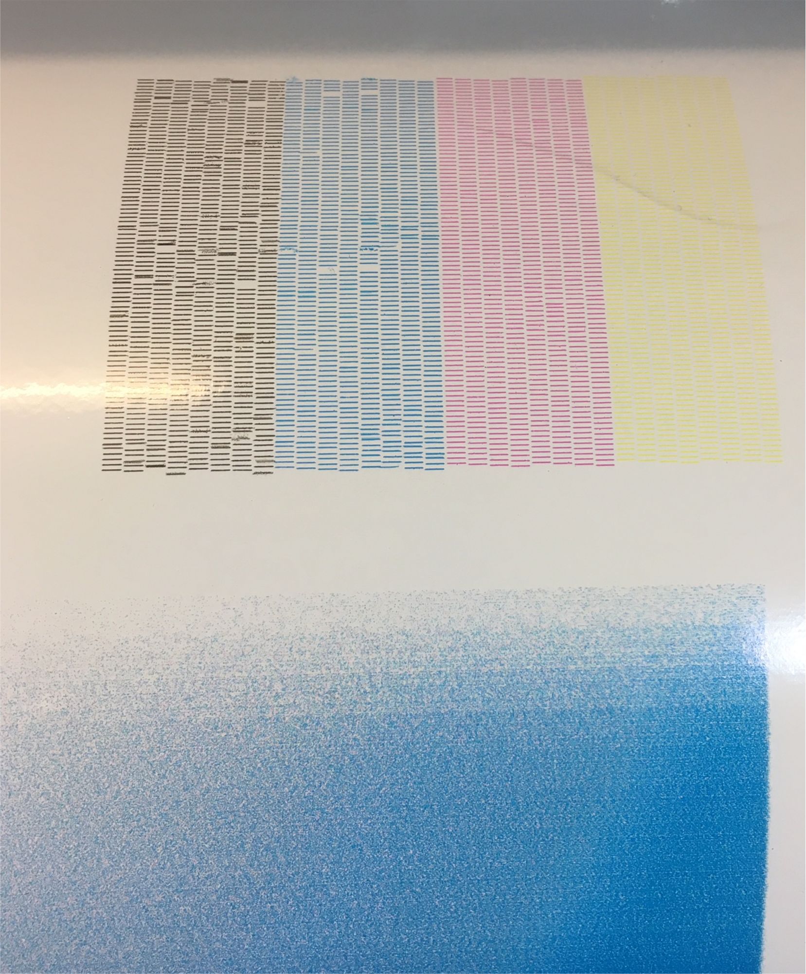

    topic67218.html i have attached a new manifold to the cyan head all went ok with test prints looking good.
    but the print is not great for precise solid blue print.
    I have adjusted the bi directional but I, assuming the head is slightly out where it has been removed and to make these changes I need to get into service mode.
    Also is this something I should be doing it or do I get an engineer in.
    Any advice appreciated

  • Chris Wool
    October 17, 2018 at 6:13 pm
    If any help it actually looks fairly close and I feel not really the problem you have.
    With all of the defections you will struggle to get top print
    If your using Roland inks the captops and pump system needs a good sort out basicly the heads are not being looked after. I feel the black may be past it’s life blue mag may improve
    Best of luck
    Chris
  • Stafford Cox
    October 18, 2018 at 8:30 am
    I’d look at replacing that black head before stressing about calibrations. All the heads are calibrated to black and with that many deflecting you’re pretty much aligning by guesswork.

    I have since printed some blue and it does seem to have improved so wont tamper with anything.
    Interesting Stafford about all being calibrated to black, there lies a lot of my problem it seems.
    Black head replacement on the cards.
    Good news is I have got the cyan back up and running.
