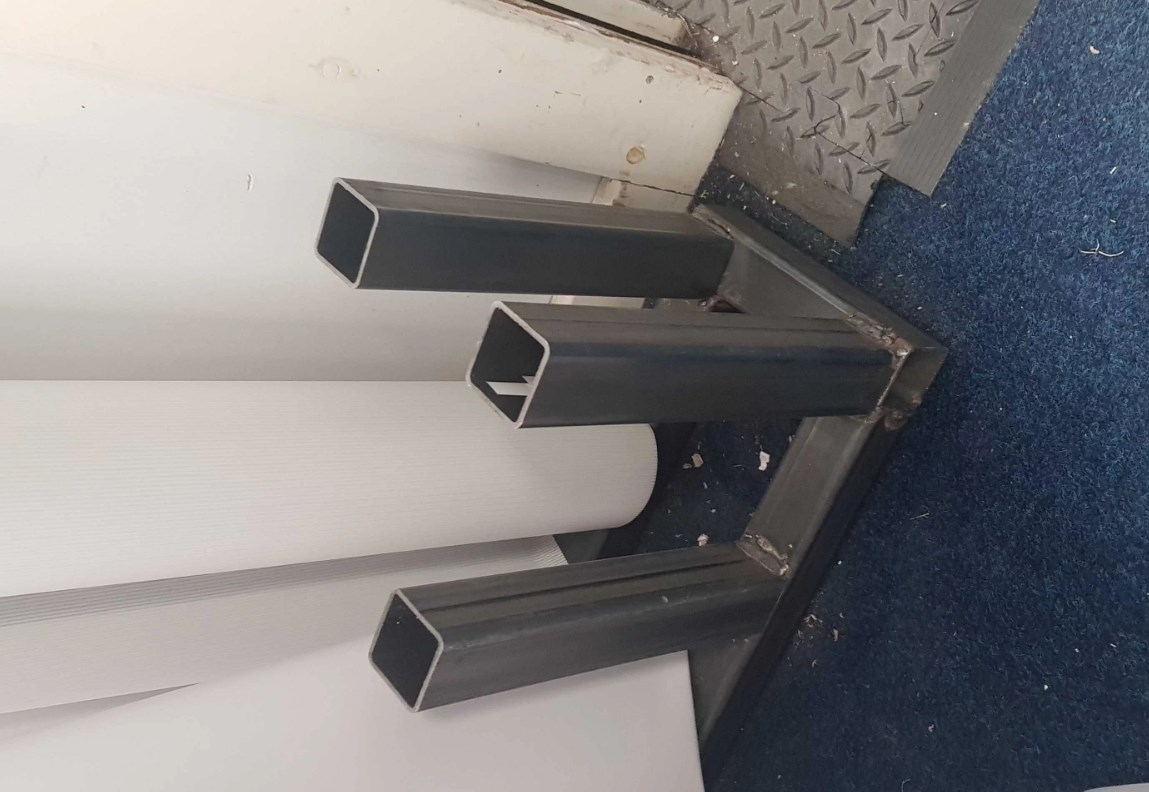

    August 30, 2019 at 11:06 am
    We got some 2inch box section, made a base, then welded some 12in uprights, and just stand it on them. No more rolls falling over.
    You may find it cheaper to get a local fabricators to make one than buying an off the shelf job.

    August 30, 2019 at 11:26 am
    Mainly wall space wasn’t available, and secondly weight.
    600mm is a long way to lift a roll up and over. Ours are 12inch max. Ours we can grip the top of the roll, and lift up over the peg.
    I’ll see if I’ve any photo’s of it from when we made it.

    August 30, 2019 at 11:35 am
    Here it is.

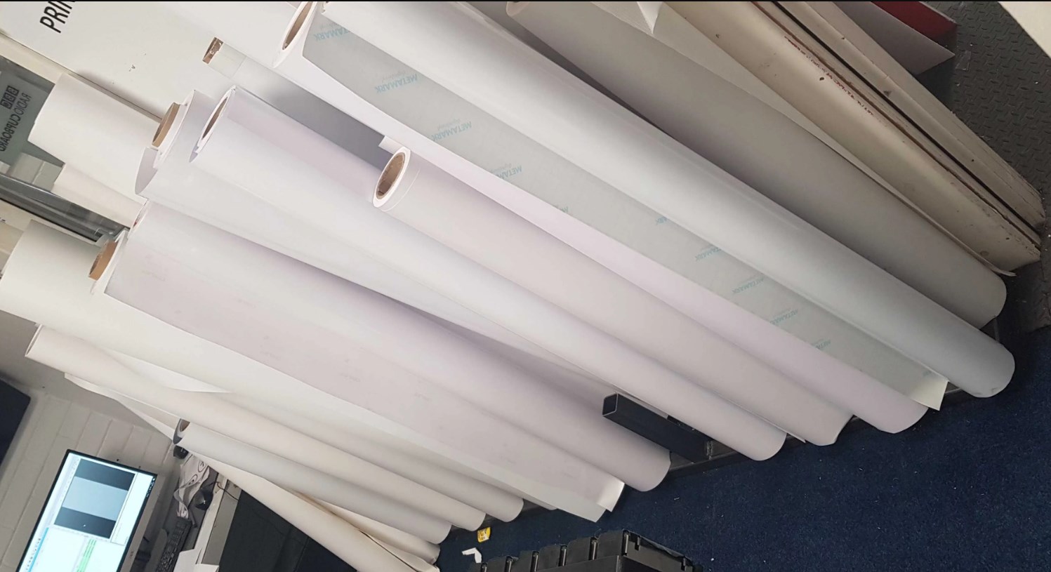

    August 30, 2019 at 2:01 pm
    We made all ours, I’d do it slightly differently by having less space between holders to get more per rack, o it the digital is bought in full rolls so no need for so many big spaces!

    make 100% sure the wood is try before using, the batten wasn’t and it ruined a few rolls and cores when they sucked up the moisture and distorted under their own weight!
    I’ve had full 25m wrap films on the batten too, that’s fine. I basically have the large racks on wheels – double sided, and can store around 18 rolls, though as I say, for the cad and wrap this could be increased. The 610 is on the wall racks.
