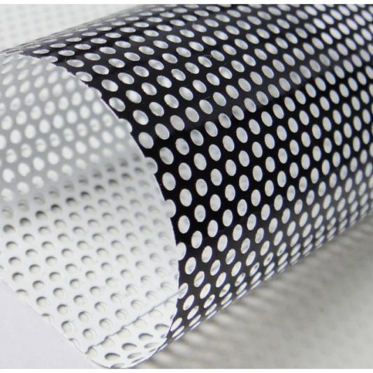

    Vinyl and uneven Thermal expansion can break glass, especially on south-facing glass.
    It’s very unusual for it to happen, but you should cover yourself when quoting. It’s only a problem when it’s a problem. It can even happen with contravision

    April 10, 2021 at 8:12 pm
    @GrahamScanlan Interesting point regarding the contravision, Graham. I hadn’t heard of breakages using that material. Every-day is a school day! 👍
