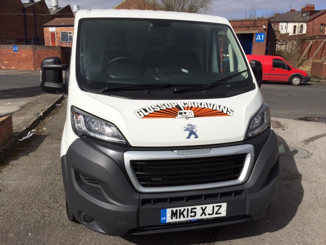

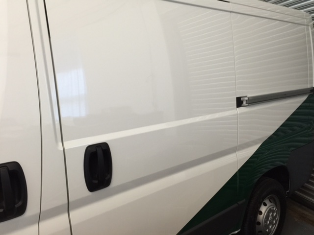

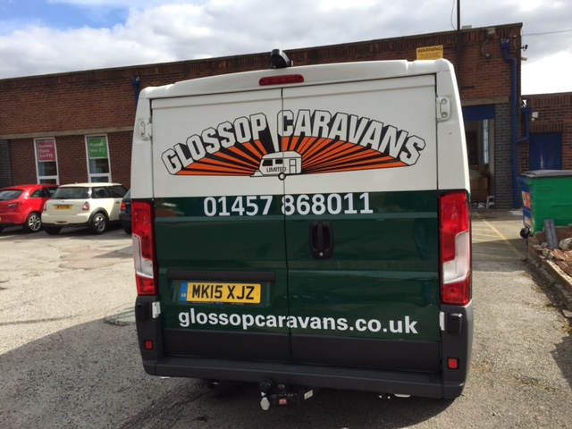

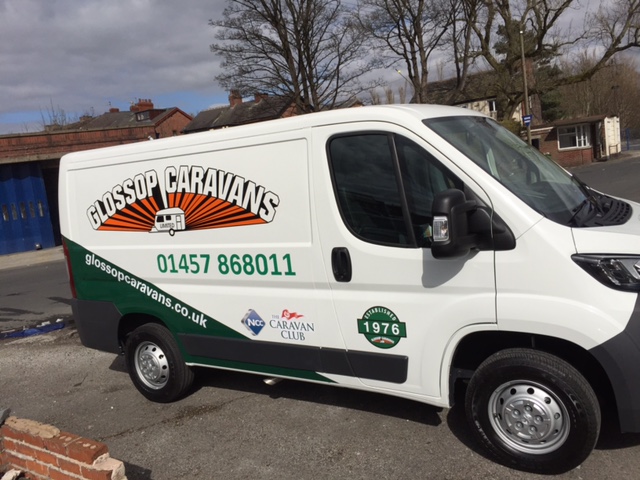

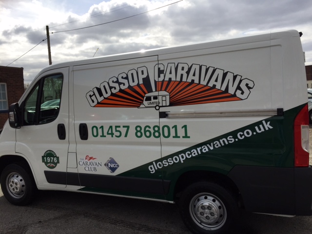

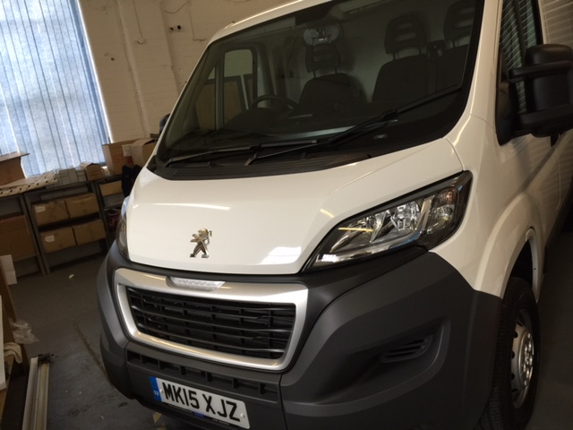

    Here’s the before and after photos i did 3 of these vans 😀
