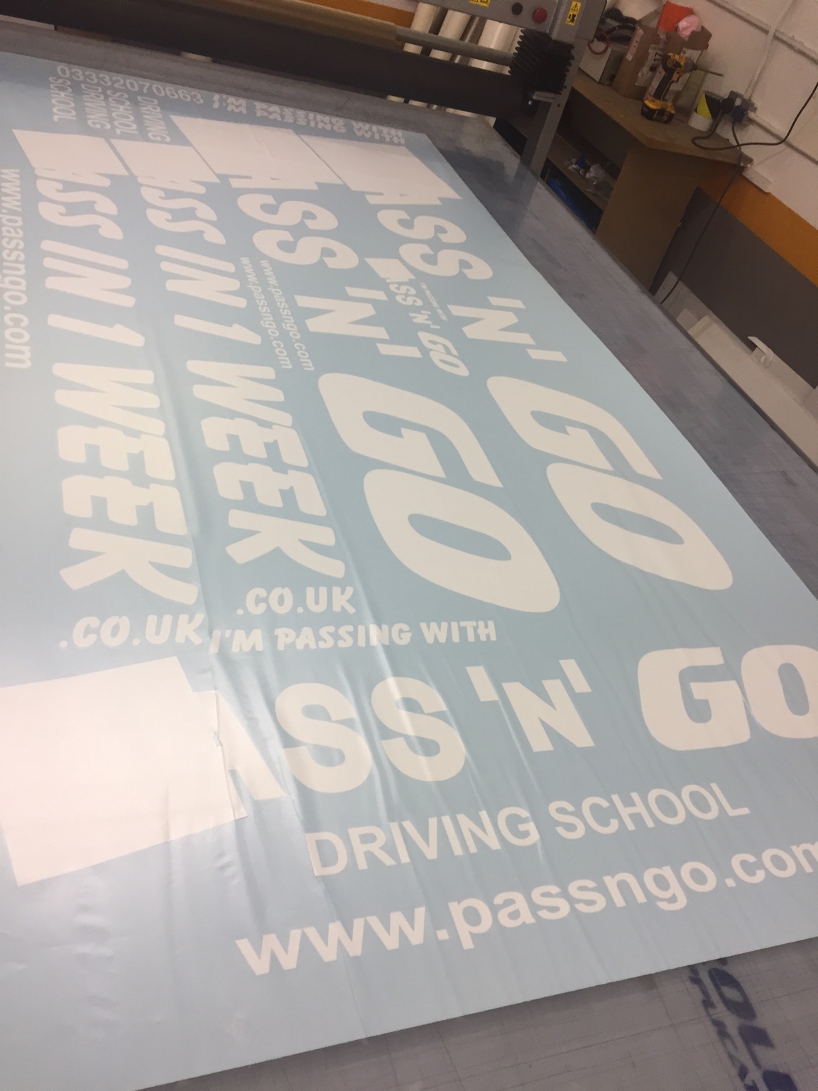

    December 6, 2016 at 8:29 pm
    Further to this topic… today was a prime example of whats happening. See picture below.
    First half goes down fine, as it passes midway the media starts to crease and ends up being a pain to fit.
  • David McCarroll
    December 6, 2016 at 11:23 pm
    Random question, is it metamark vinyl you are using? We had something along the same lines before and i was determined it was our machine (not a RR), had lots of trial and error and eventually realised that for some reason some metamark vinyls would create this problem but oracle and 3m are completely fine. Its almost as if the backing on the metamark liner is slippy and causes it to bunch where as the other brands are more paper feeling.
    We discovered the reason when laminating a 2x1m Air release print which bunched terribly, tried again and same result. switched to a 3651 air release and no problem, switched our cut vinyls the next day and never had a problem.
  • Chris Tennant
    December 6, 2016 at 11:35 pm
    quote David McCarroll:
    This has actually been in my mind, along with the orientation of the weeded media on the backing.
    This was hexis material i think, but we use a range. Hexis, metamark, avery and so on.
    We tend to stick to certain makes for colours, hexis being black and white. But this happens 75% of the time. Only way to really stop it is to put a relief cut in it and the just allow the roller to roll over it.
  • Warren Beard
    December 10, 2016 at 9:16 pm
    Yes we have the same issue and it’s the liner on the Metamark M7 vinyl that causes this. Metamark know about the liner problem and are apparently working on a solution but can’t say when that will happen. I can only guess it’s a small market having this problem so they won’t be in any hurry to change it.
    December 11, 2016 at 3:20 am
    I don’t know about the Metamark issue creating this but anytime this sort of thing has happened to us, was down to the room it was in being too cold. The media would have a sort of light wave in it and then when you applied application tape which was going down tight and flat, it exaggerated the wave as it moved along the table and by the end the wave was pinned down by the tape causing the creases. I later moved our RollsRoller into our print room and have never had a problem since.
    I am merely pointing this out as its good to know options of what it "could" be, i.e. Room Temp but then again could be the liner as has been mentioned.
