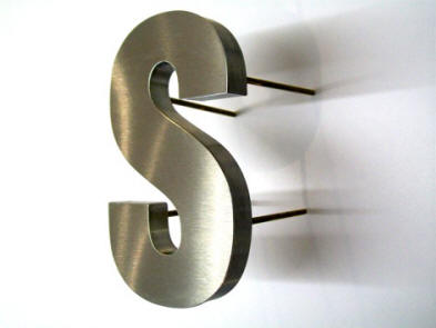

    whoever is cutting your stainless steel letters, ask them to solder threaded rods on the back.
    you press them up like you do when making normal locator templates.
    then just drill holes where the locator/rod hits.
    squirt in some liquid fixing resin and slide in the letter rods.
    you just leave the letters there and the liquid will solidify securing the letters very strong.
    these types of fixings are also ideal for rough-cast or sand stone walls where the surface is very uneven. the roads allow you to level all the letters without distorting them by fixing to an uneven surface.

    If the stroke on stainless letters is extremely thin then another option is to weld pins to the backs of the letters instead.

    Thanks for the replies. Pretty much what I was suspecting really but Rob how well do you think studs will work on a timber fascia? I always use that method for brick or stone but not used on timber before. What sort of glue would you recommend?
    I have only ever used them on wood once. has to be over ten years ago now and the last i passed "they are still up! 😀
    i had them on built-up stainless letters and it wasnt thru choice, the letters came with the threaded rods as opposed to the metal locator stud type fixings.
    i am suggesting the rods because of how thin the stroke/leg of the letter is and how secure it will be long term.
    back then i did not know the best adhesive fixing so i used a 3M 2-part adhesive we keep in stock. i forget who told me now, but was assured "big-head fixing type adhesive was fine to use also. i had both in stock but opted for the 3M one.

    Use chemfix either single or 2 part
