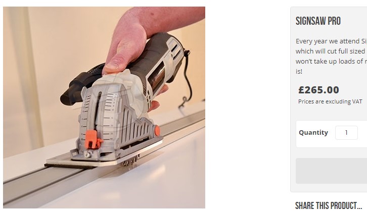

  • Ewan Chrystal
    August 1, 2017 at 9:52 am
    Anyone used these before?
  • Kevin Mahoney
    August 1, 2017 at 9:55 am
    Looked at these a while ago, looks really good but as I bought the festool track for the milling machine I guess I’m tied into buying the festool saw to match up
  • Dan Osterbery
    August 1, 2017 at 10:05 am
    We had the festool saw and guide, very similar to this saw system, before we bought the inglet verdi cutter. Time saved with the new vertical saw is incredible. Saw and guide systems work well though, we used ours for over 10 years.

  • David Stevenson
    August 3, 2017 at 8:01 am
    quote Ewan Chrystal:
    signsaw-pro-982
    Bought one of these and a total waste of money! Makes a terrible mess even with a high power vacuum attached, very restricted to what depth it can cut, and massively over priced compared to similar models available for the wood working trade. On the plus side does a very neat cut with the correct fine toothed blade if your prepared to clean the entire work piece and cutting area afterwards
