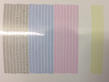

Activity Feed Forums Printing Discussions Roland Printers Versacamm VP300 Yellow is only half printing
  • Stafford Cox
    May 5, 2017 at 8:17 pm
    Most likely a damper. Try swapping the 2 yellow dampers and see if the fault moves.
  • John Singh
    May 6, 2017 at 2:24 pm
    Thanks Stafford
    I’ll try and give that a shot
    Appreciate your help :thumbsup:
  • John Singh
    May 16, 2017 at 10:58 am
    So it was the damper in the end
    Anyway managed to snap the little plastic connection the damper fits on so had to get engineer out
    He gave it a full service which it needed so nothing lost
    But thanks for your help :thumbsup:
