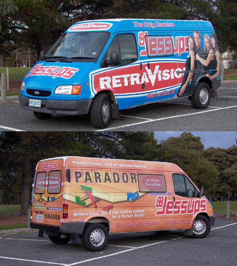

    A van wrap we did for a local store, Jessups Retravision. Just finished yesterday. Both sides are different (as you can see from the pics).
    They are an electrical appliance (Retravision) and furniture retailer (Parador flooring).
    Gray has probably heard of them, they are in Launceston, Tasmania which is only about 2 hours from him.
    Any feedback would be appreciated.

    Great work Scott, what colour was the van to start with? Was is white as the roof is?
    Did you do the job from start to finish ? ie: design, print apply or was some of the work done by others?
    Are the sides one print or was it done in sections ?
    Sorry about all the questions !! Just want to learn more.

    The van was white (same as the roof).
    I did the design in Photoshop on a 1 to 5 scale and then printed it on our printer. It was done in panels aprox 1300mm (54 inch) wide and then applied from the rear to the front (to get the overlaps going the right way). The windows are printed on one-way-vision perforated window film. We used Avery 1005 EZ cast vinyl.

    Could we share some information on the tech side as you are obviously very good at application as this model van has a lot of tricky bits to catch you out the depth of some of the moldings and the side of the roof all those indentations (im breaking into a sweat just thinking about it).
    What type of printer and inks was used.
    What type of preperation was done to the van prior to application.
    Did you use any special tools on application.
    Thanks for sharing this with us

    I printed the graphics on a Roland Soljet printer. It is not a true solvent printer, bit the graphics are waterproof and will last 3+ years unlaminated.
    The prints are laminated using a spray before the graphics are installed.
    It was installed dry (Robert would be proud!) and I used the “heat 3 times” method (which I learned here) for the recesses.
    If you have any other questions, please ask.
    Scott

    We prepared the van by firstly washing to remove normal dirt and dust.
    Them we cleaned it with a solvent cleaner to remove wax, silocone pollish, grease & tar etc. ie normal road grime.
    After this, and just before application of the vinyl it was given a final clean with isopropyl alcohol. This needs to be wiped off the panel before it evaporates on the surface. We usually wipe the alcohol on the area just before we apply the vinyl, to remove any finger marks, tape marks etc caused from the previous panel being installed.
    Tools, nothing special just 3M gold squegee with protective sleeves, felt squegee, heat gun, knife and lots of work with bare hands and fingers!
    Hope this helps a little.
    Scott

    can i ask what type of vinyl you have used on the van and what you used on the windows mate? just me being nosey again 😉
    thanks for sharing!

    I used Avery cast SEM 1005 EZ vinyl for the van body and Clear Focus Jetview perforated window film. Both of these were laminated using a spray.
    Scott
