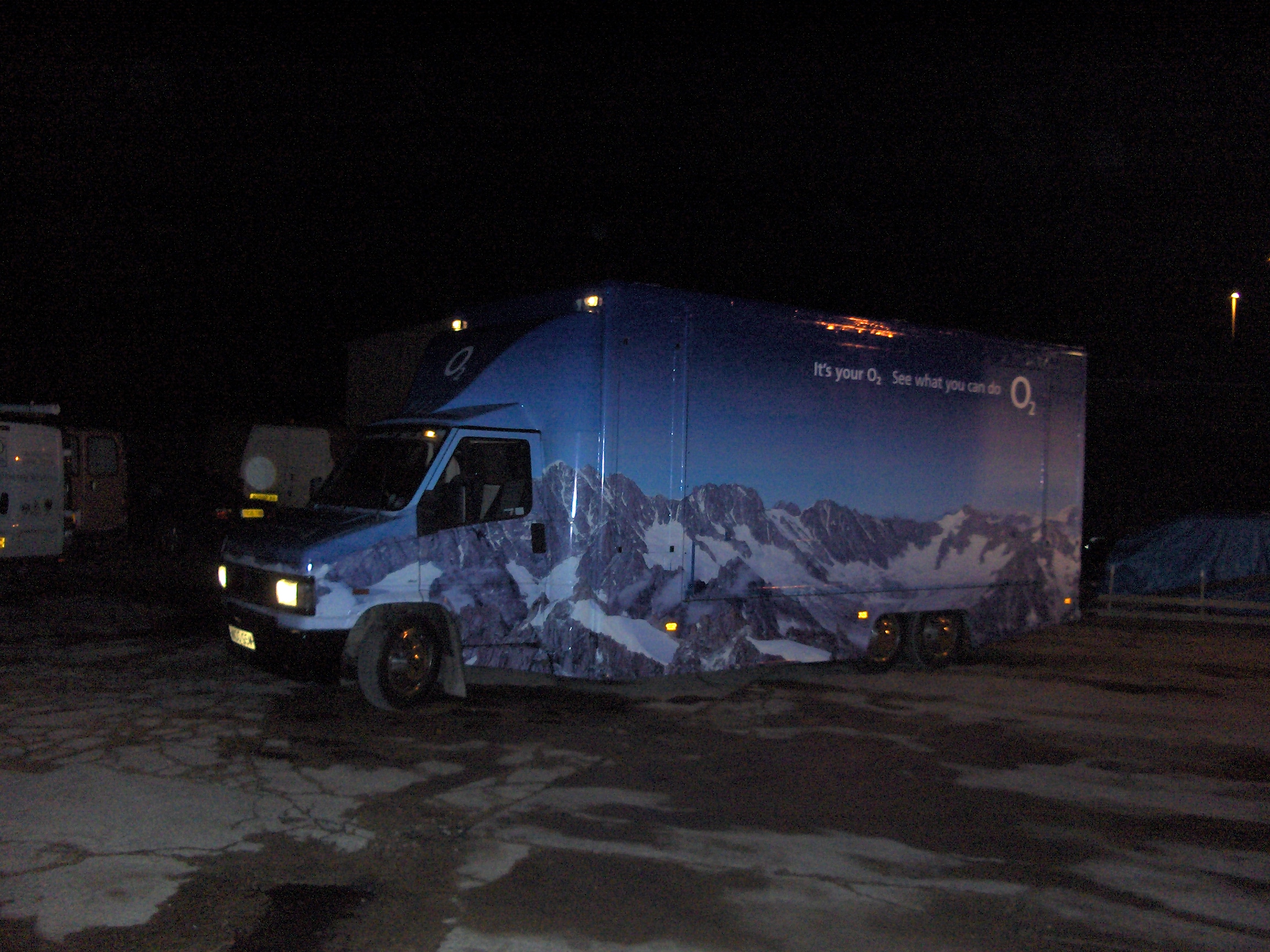

    To get the pic to go around the vehicle like that mate, do you start at the rear and move forward, or do you just start at the front and go around?
    thanks for sharing
  • Phil Halling
    August 30, 2006 at 7:28 am

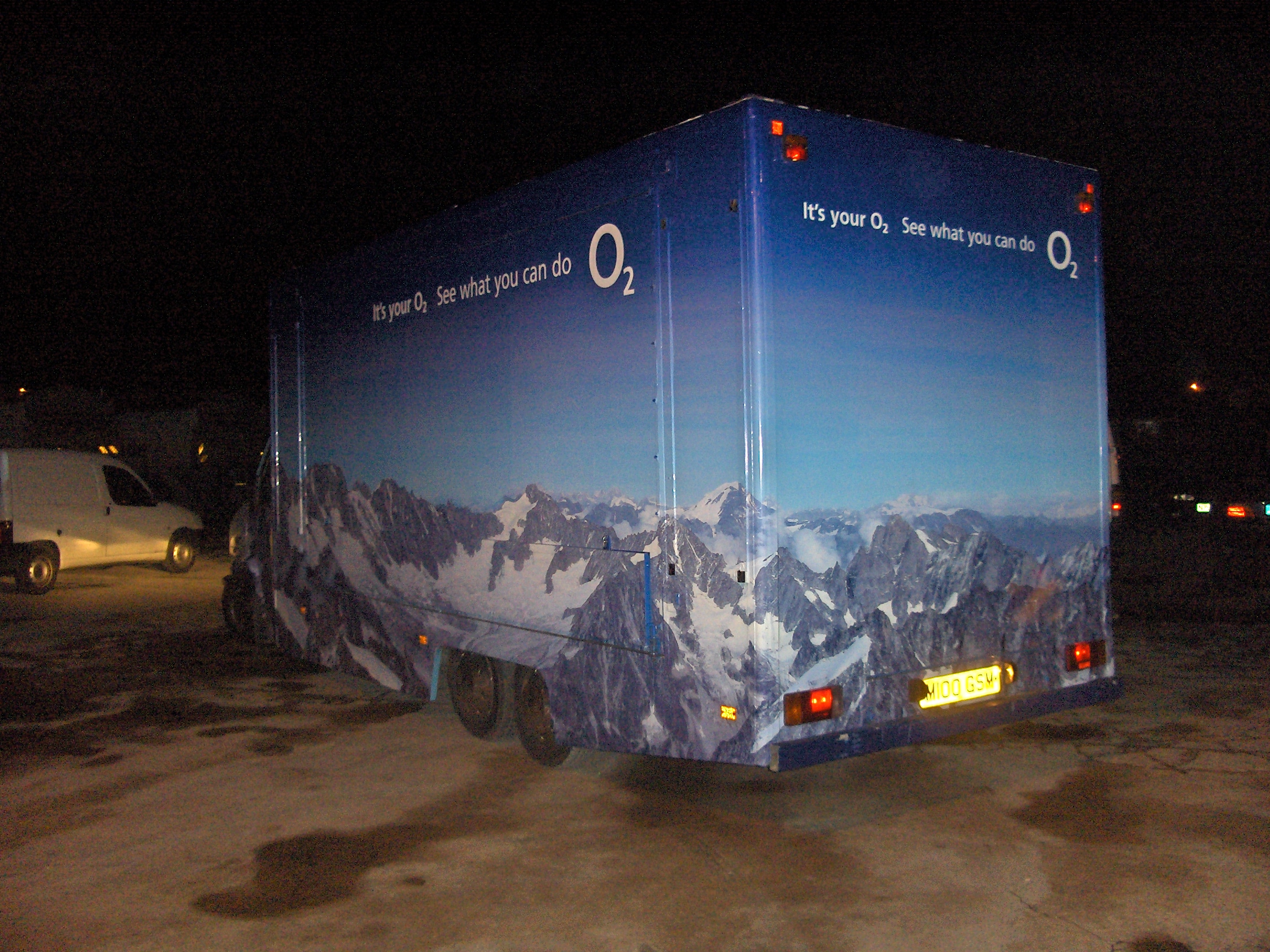

    That one was designed so that the extreme ends of the mountains (Mont Blanc actually) were approx the same level, started middle of rear and joined at the front grill, where the vehicle obstructions such as grill, headlights etc. make it more forgivving for adjustment.
    The hardest part was to get the blue vignette to work properly down the sloping air deflector.

    Phil that looks suberb ………whats the time scale from prodution on the comp to completion ? wish i could see it being done …never fails to impress me 🙂
  • Phil Halling
    August 30, 2006 at 8:02 am
    Computer time: 2 hrs
    Print time: 9 hrs
    Fitting time: 31 hrs ( total for 3 men)

    That is incredible, the way the picture follows through onto the cab, superb. One of the best I’ve seen.
