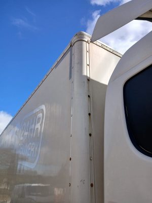

    I have been asked if I can wrap a delivery vehicle for a theatre. i have attached some pictures of the same vehicle model but this isn’t the actual one. the one in question is already wrapped and they want it covered up with their stuff. most of it will be white with some graphics on the sides and rear.
    i personally won’t be wrapping it, I will be getting someone in locally that does it.
    my question is, do I need to use vehicle wrap vinyl for everything? most will be white, it is all flat and just needs covered up. so I am wondering if I need a particular type of vinyl?

    March 6, 2023 at 10:45 am
    No you don’t need to use a cast wrap film for the sides of the box.
    We’ve used MD5A in the past, and whilst some may disagree, a quality monomeric MD3, would probably suffice too (assuming you’re printing it) even cut vinyl, M7 would suffice, and the M7A will make fitting large panels much quicker and easier.
    If it’s already wrapped, and you’re intending to go over the top, it may be worth using a blockout vinyl. Or just strip the thing.

    It really depends on what part of the vehicle you are working on.
    * For anything on the sides and rear, I would use grey-back adhesive, Polymeric Digital vinyl with a Laminate.
    * Unless there is actually complete coverage of the front cab unit, spoiler etc, then again, Polymeric digital and laminate would be what I would use.
    * If the cab unit and spoiler have to be completely covered/wrapped, then I would use a digital wrapping cast and laminate for this area only.
    * As for covering over the existing box wrap. Personally, I would rather remove the existing wrap, clean it and start fresh. Just explain that ANY imperfections of the existing wrap, from bubbles, scratches, chips, shrinkage, grime and in particular, “panel joins”, will ALL be emphasised and stand out more, once the new vinyl is fitted over the top and will only make your work look bad.
    Put that in writing in an email, but state you are only advising on this, and will fit on top of you would prefer NOT to incur the removal charge.
    Ask your fitter how much he wants for removing the vinyl first and add a “minimum” of 50% to that for yourself, and tell your customer there will be a “Graphics & Adhesive Removal Charge” at ex-amountยฃ per hour. Remember, all chemicals, paper towels, rags, bin bags etc for the removal will end up out of your costs unless your freelancer includes this in their price.

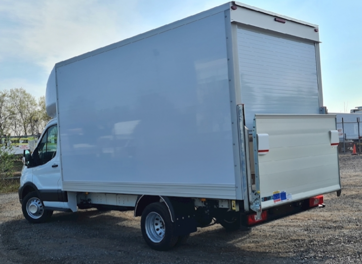

    I’d just like to resurrect this post if I can as I have a request for a very similar job but it is purely to cover the flat side panels on a box van that has no current graphics.
    The customer is just wanting to cover the shadow left after previous cut vinyl graphics were removed, because when it’s washed, the previous name is very visible!!
    It will all be just white with no print for now. He may decide in future to add his name/contact etc.
    He plans to keep the van for at least another 5 years.
    So my question is, would you use a laminated unprinted digital vinyl or just a white sign vinyl?
    I presume a laminated digital would be more robust against potential scratches & general road wear?

    I would just use a sign vinyl, air release would be even better.something like M7A or Image Perfect will do the iob
      March 4, 2025 at 2:18 pm
      Do your first drop square to the edge, then with tape mark a 15-20mm overlap, align.next drop to that and away you go.

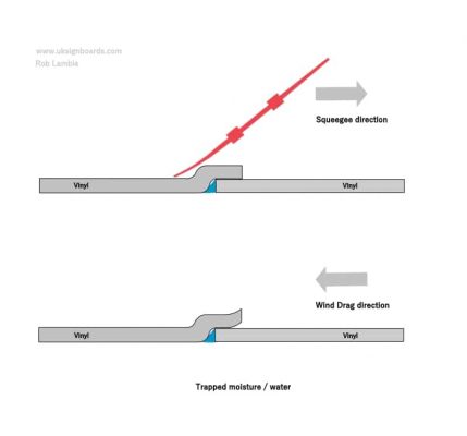

    Have a look at the attached image.
    This side view of two overlapping panels of vinyl that have been applied wet. It shows the best case outcome of the application, and that is. Moisture trapped in the overlap.
    The squeegee will hit the overlap like a ramp and will not be able to expel the soapy water trapped at the panel join. It will also lose pressure on the top flat of the vinyl due to the ramp motion, again, leading to the lack of properly expelling moisture beneath the two bits of vinyl.
    Along comes contnual wind drag as the truck is traveling, coupled by possible shrinkage tension of the newly applied vinyl, and those overlaps will start to lift, leading to a fail.
    It could be argued, this is just my opinion. But its an educated opinion of persoanly installing tens of thousands of these overlapping panels on thousands of trucks i have wrapped over the past 35 years and i can honestly say i have never once had a “truck panel join” fail.

    Now lets say it is because the vinyl overlaps onto vinyl?
    This being the case, every multi-layer cut vinyl job in the world would be failing on the leading side of the graphic.
    Tram and train wraps travel in both directions. what happens there?
    Again, it could be argued “some” of these may have edge sealent, butt-joins or even primers used. but the bottom line is, most dont.
    Anyway, I am rambling on, so i will shut up. ๐Ÿค”๐Ÿ˜‚
    • Myles Brewer
      March 13, 2025 at 5:37 pm
      ๐Ÿคฃ Great rant there Rob & point very well made!
      Like you say it’s obviously one of those odd things that has perhaps become an accepted way of doing things but without any real scientific or logical thinking.
      I did actually think about the fact that most other vehicle graphics don’t fail at the leading edge which does make the argument null & void. But having said that, there is certainly no harm in doing it from back to front if it makes anyone with a little hint of OCD feel better!!๐Ÿคฃ
      I do 100% subscribe to the dry fitting method though & have never felt comfortable using liquids in any situation bar large interior windows.
      It intrigues me these days to see all the paint protection films being fitted wet!! I presume they must be using specialist liquids which promote adhesion very quickly after fitting?
