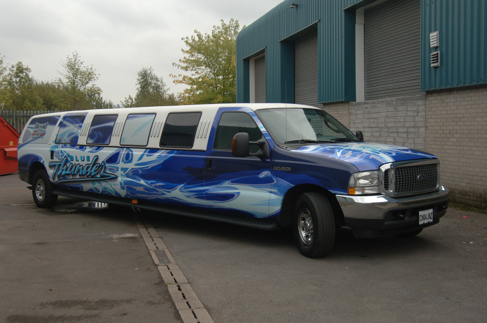

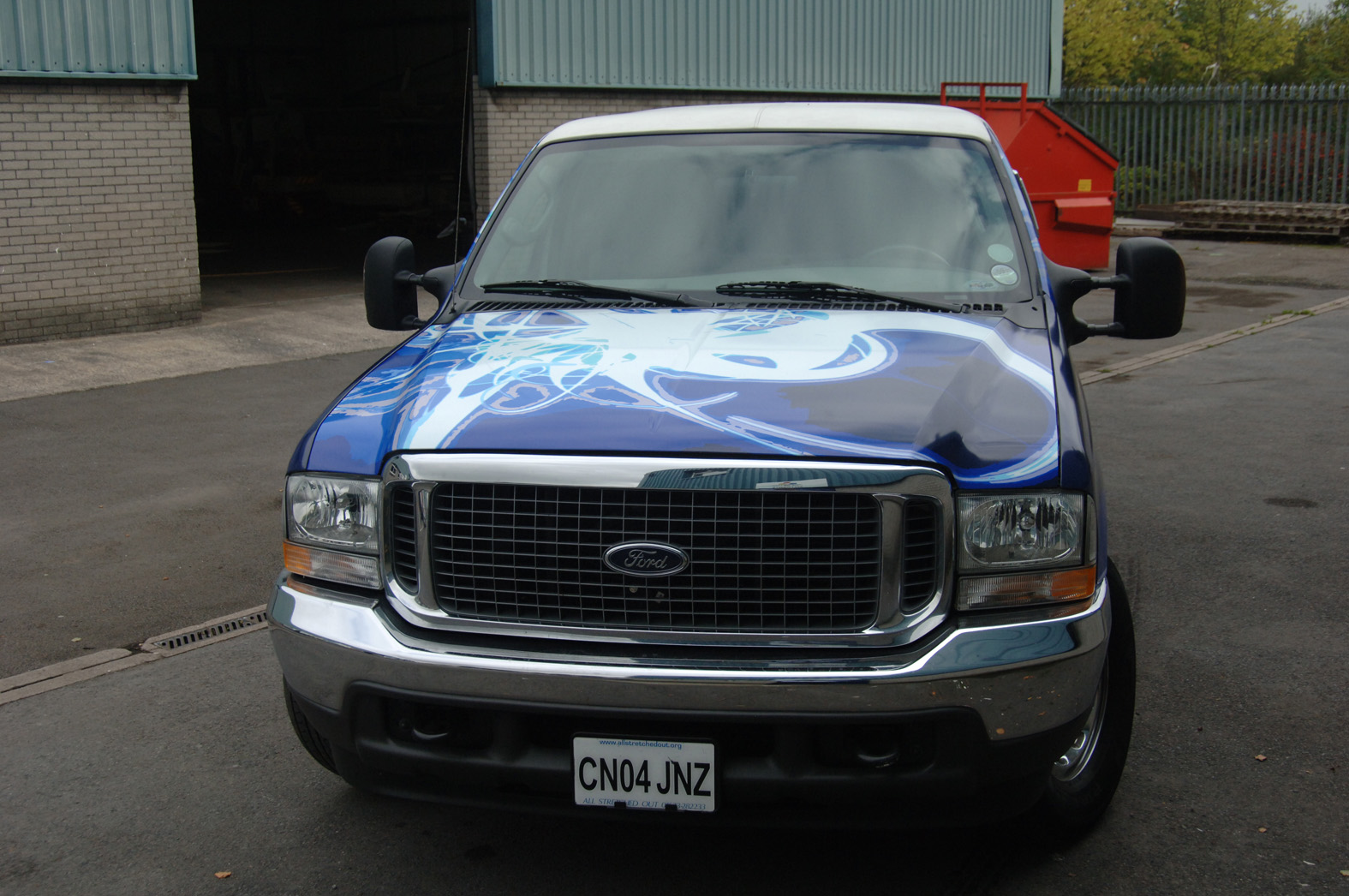

    Hey guys, this is one i did last week, hopefully got a few more orders. done with avery 2004 easy apply.

    Good job! Works really well. I’m in South Wales and have seen S.T.T.L limos around so I can’t wait to see this on the streets of Cardiff very soon. Where are you based (just wondering if there is someone I can recommend for wraps locally, I’m vinyl cutting only) and would you by any chance reveal how much you charged the customer?

    Nice work Ben, did you do the artwork or was it supplied ?
    We’ve done a couple of stretched hummers this year and these long buggers are not as easy as they might first appear.

    Cool. Was it done in horizontal pieces or drops?
  • Ben Hansen
    October 16, 2006 at 8:12 pm
    It was done in one 11 metre run. Longest bit of vinyl Ive ever seen lol 😮
  • autosign
    October 16, 2006 at 9:14 pm
    That must have been a real challenge to fit then!
