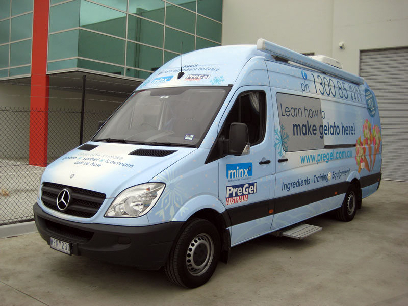

    Customer supplied artwork and rejigged to keep it off certain parts of the vehicle.
    Materials Used:
    Exterior:
    Avery 1005
    Avery 1030 Laminate
    Exterior Glass:
    Clear Focus
    Avery DOL 4000 Laminate
    Interior:
    Avery 2003EZ On the sidewalls
    Avery 2000 Gloss Laminate
    Interior Floor:
    Arlon DPF 8000
    Safari Floor Laminate.
    My biggest vehicle to date 😛

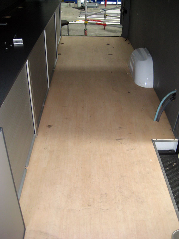

    Was the floor printed as well? not obvious by the photo…..
  • Jason Xuereb
    November 14, 2008 at 3:46 am
    Yep its a grey color. Was originally like a fake floor board finish.

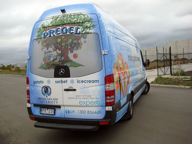

    I found the recesses on these vans to be very deep. Plenty of post heat required!!
  • Jason Xuereb
    November 16, 2008 at 12:04 am
    Pryam I cut the recesses free. I rather have my wrap stay on properlly then tent up and pull up in the recesses. I think that looks ugly and a small white gap is a small price to pay. The van is so big in the scheme of things it won’t really matter. On this design any way it works out because some white border ties into the design abit.
  • Pryam Carter
    November 17, 2008 at 2:03 pm
    I don’t blame you on this recess.
    I did a part wrap on one of these over a year ago, the guy brought it back two months ago because one of the sides has popped, the other side and the rear are both perfect.
    I was dubious whether it would stay and very nearly cut it.
    Wish i had now.
  • Jason Xuereb
    November 17, 2008 at 9:40 pm
    A Ford Transit I did about two months ago had popped in some areas. I can’t work out why I put the stretch in a lot of the vinyl and post heated it properly.
    It only popped on one panel maybe insufficient cleaning or application temperature I guess.
    It didn’t matter on that job because it was short term.
    I might have to give the new 3M a go.
