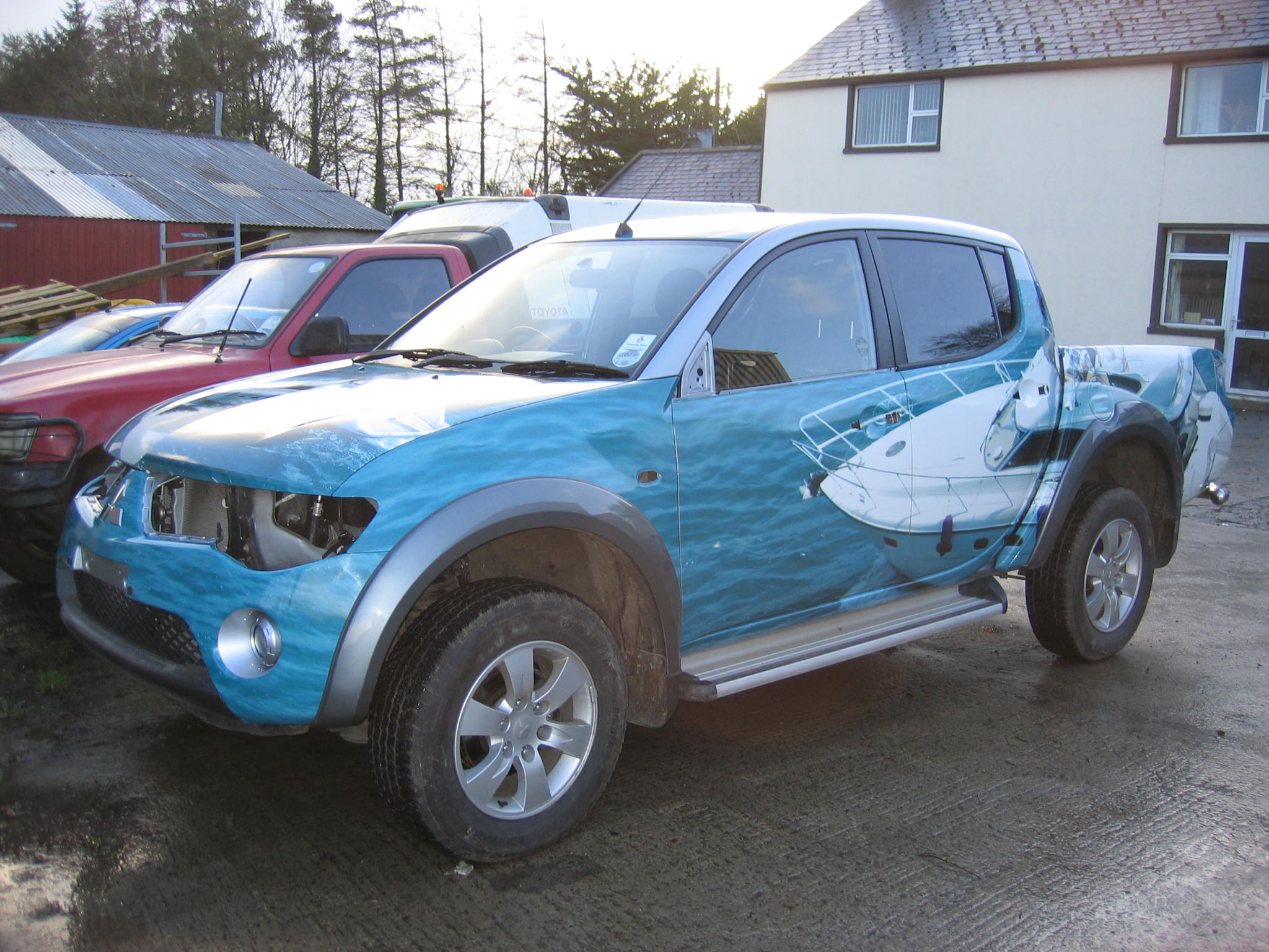

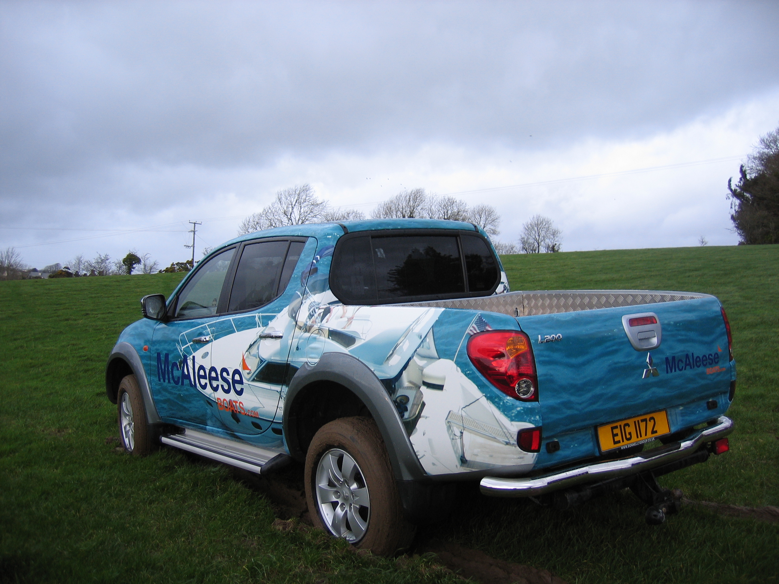

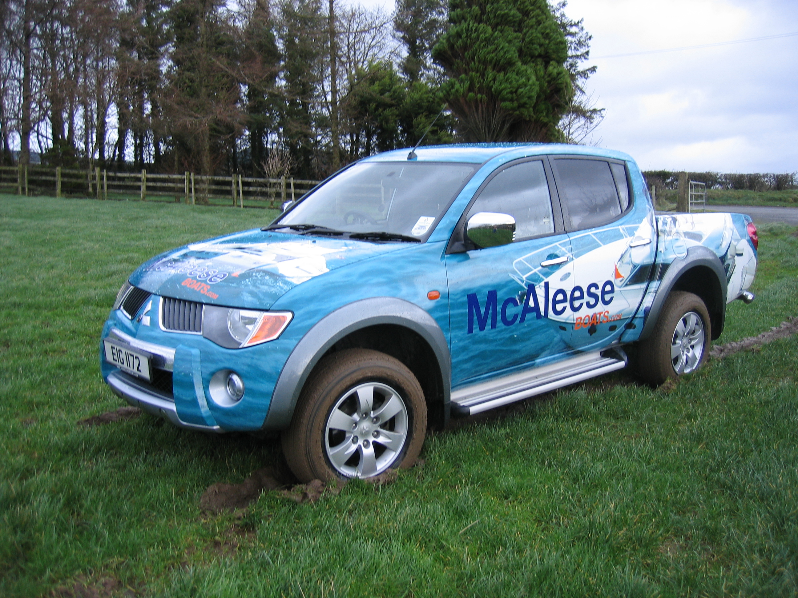

    Haven’t been on for a while though i would post a few recent jobs
    Lost my usual login of IDGNI so now you all know my real name
    Look at bottom photo first

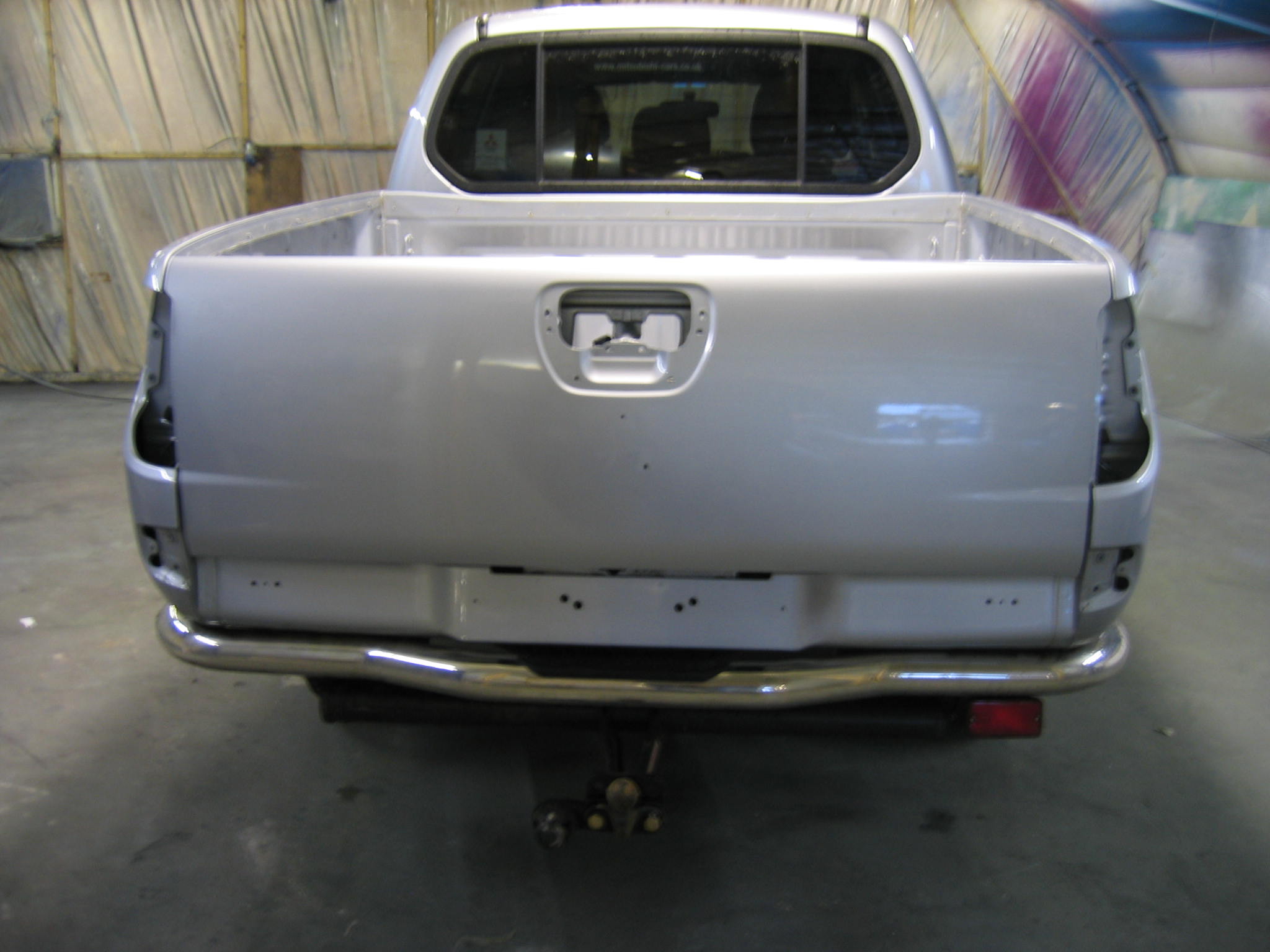

    This was a pain to do as customer wanted everything wrap so we even removed the back loading bay to get right behind the cab done,
    worth the effort though.
    Pity i didn’t take a photo of the tractor pulling me out of the field after we got stuck. ( saw an advert of an L200 going over a mountain last night on TV. let me tell you it’s a load of bull as they would get stuck in a puddle 😀 😀 😀

    Now thats a proper job, all trim removed etc.
    Can I ask how you transferred the sea effect to the parts without a boat? was it just clip and paste?

    we used Arlon and cast and laminate printed on Rockhopper II 64" with Inktech solvent inks
    2 staff to apply in all aprox 2 days and my neighbour, a car body repairer to strip it, ( by far the best as they know where all the clips and rivets are so that you do not wreck them).
    the art work worked out well, the water effect was cropped from main picture and mirrored to give more lenght , i will post original picture later.
