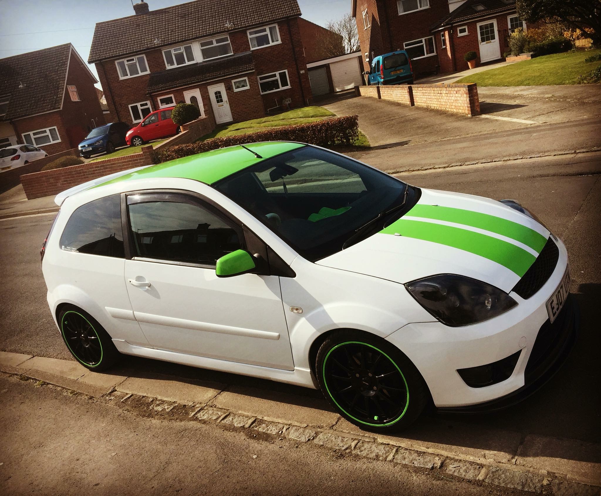

    Hi, I’m having problems with vehicle wraps I’ve tried a couple of roofs and smaller bits but I’m not happy with the results. It’s not professional enough to charge for really.
    The last two have gone wrong and cost me vinyl and wasted time due to me ripping it. I’ve told myself until I’m happier doing it or at least trained I’m not taking on anymore work in that area.

    It probably is temperature related, but this was two days ago, and the building we were in was warm.
    This was using chromatic vinyl, a new brand I am reselling, the green however is pretty poor quality
