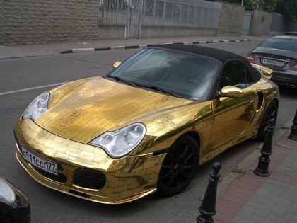

    NOT my work… I have no details of who did it using what vinyl etc… but thought i would share the find anyway.

    to be fair it looks like there has been a lot of thought put into it………on the picture showing the exhaust they’ve put the screw heads in exactly the right place for example
  • David Rogers
    24 November 2010 at 09:08
    Def. a wrap?
    If I saw it – my first guess would be paint.

    I think its quite nice, I would say its real gold and not a wrap,
    perhaps gold leaf? looks to intricate to be a wrap, and such a good finish

    I have seen a completely Gold Leafed car before and it doesn’t have the shine from the gold like this one. Also, leafing the car would damage the paintwork.
    Also, all those rectangles and designs would need to then be painted on "after" application of the leaf. I would imagine things getting a bit messy and laborious.
    I guess that means nothing if the guy has money to burn….
    Personally, I do not like it… I don’t even like the car itself.
    My “guess” is that it’s 3M Gold Mirror Cast which has been printed onto, laminated and applied.

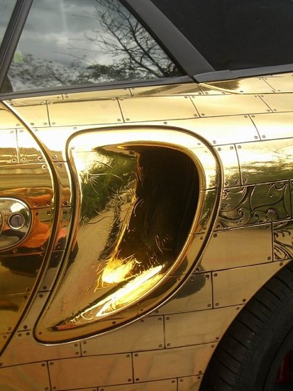

    I think the placing of the screws/rivets is just to precise for a print

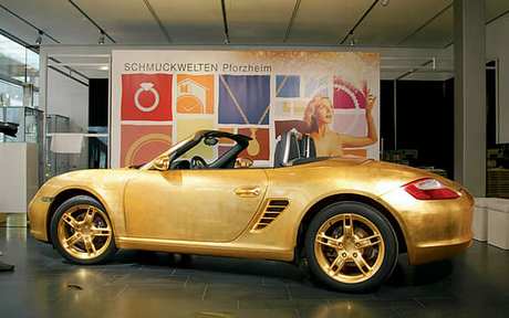

    Gold Leaf one here…..

    yes, when i look at the screw/rivets, i see what you mean! 😕

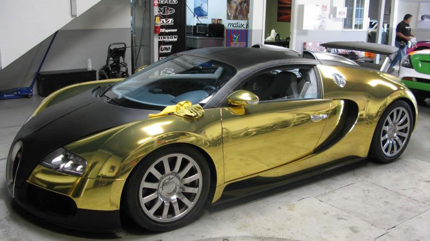

    yeh, the 3M cast mirror film but often used as a wrap. but "does have its limitations"
    the following is done in 3M gold mirror vinyl.

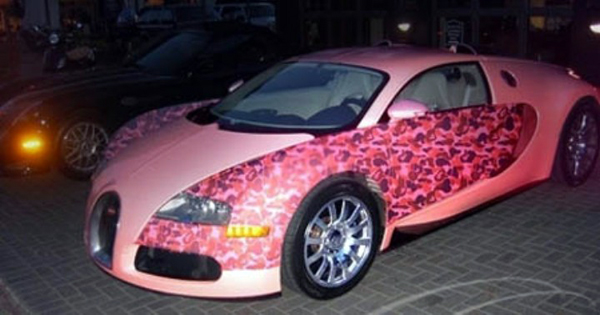

    Modern day pink panther mobile?

    I agree with Martin. I think it is signgold too. I used it on a mega rich boat here some time ago, and to the uninitiated you can get a version that has a swirl/crease effect to imitate gold leaf. Cost a fortune to buy here. I did a boat rego on both side, a huge name on the transom and fly-bridge. Charged him $900 and he didn’t even flinch. Heaps cheaper than ‘real’ gold leaf.
    As far as the lines and rivets go, its most likely hand painted with a pin line brush. We have a guy locally that does that effect on utes and traliers. Very effective.

    thing is, you are back to same scenario with the screws/rivets. they are strategically placed which i would guess could only be done after the wrap/leaf has been applied, due to alignment.

    signgold it is not, it only comes in small sheets, and therefore you would see overlaps and joins,
    The porsche was probably produced by someone who has never seen a plotter, or a book of gold leaf, maybe a jeweler, or a metalworker, but it was done by thinking outside the box…?
    I know that metals can be sprayed using specialist equipment, so maybe it was done like that. we should not assume it was done using "signmaking" methods.

    It could just be electro gold plated, they do car wheels, grill and badges etc with it, so I’ve no reason to believe you couldn’t do a whole car like it.
    I thought about having my phone done with it once, but it’s not a nice image. It’d bond and stay on there well enough, but it’d be seriously expensive to do a whole car with it though.
    It’d be quite dear to do it in leaf, or even a wrap, but electro plate would be frightening. To line it like that by hand would be tedious and time consuming, but not really that difficult, so it is feasible.
    To give an idea, a couple of hours is more than long enough to coachline a Rolls including the hubcaps, without pushing yourself too hard. I once spent two days lining one of my own modified cars, and it was nowhere near the complexity of that Porsche, but the style of lining on that gives far more tolerance than you’d ever get with normal lining.

    the screws are inconsistent, strategically placed. lines fade in and out at recesses, lines are not a constant width and more… all sorta signs its been painted by hand.
    the exhaust pipe may well be gold leaf…
    the fancy scrolls and swirls maybe done in something clear to give the effect… a bit like how the traditional guys do glue chip on mirrors? [naive description there]
    perhaps to go to a real extreme and wrap it in clear after it has been painted by hand to protect?

    Just a little addition, had a bit of a web search, and it’s very likely to be electro plated, there’s a few companies that’ll do it.
    A company called Alchemist who are based in London, will do it in leaf, but it’s really not the same, it looks like the effect on the second Porsche.

    Bob it could be sprayed, years ago we were repairing crankshafts by spraying steel, so even though i have not come across it, no reason why real gold could not be done the same way/

    Ok, I’m struggling a little with the spraying steel. First read it and thought, hang on a minute, you’re going to be sending me for a tin of tartan paint and a spirit level bubble next, but I’m guessing that’s not the case… If that can be done, it’s a process I know nothing about.
    27 November 2010 at 00:04
    Bob
    it works by spraying what is essentially iron filings at high pressure and heat onto the surface of another metal, the pressure causes the particles to weld on impact, not a new process, I think it was developed many years ago, the idea I believe came from noticing that bullets welded themselves to tanks on impact during the first world war, cold be wrong though…
    found this a s a quick exaample http://www.metallisation.com/

    If what I have read is true then it is covered in 18kg of gold leaf. Search for denis simachev porsche.
