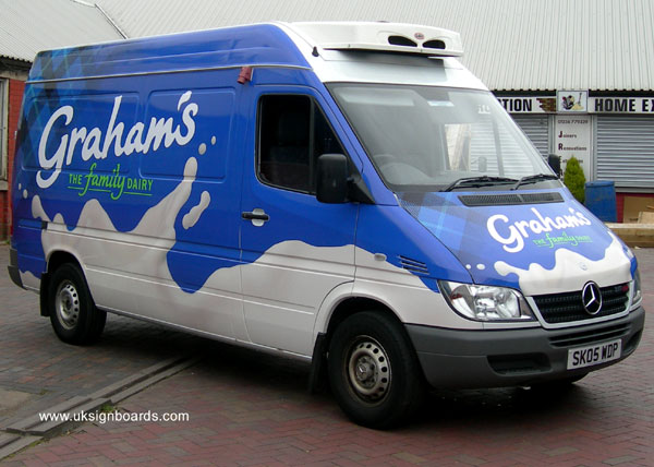

    Posted by Robert Lambie on June 20, 2006 at 1:56 am
    below is a picture of a van andrew and i wrapped on friday afternoon. its not complete in the picture sorry… i forgot to take finished van 😕 😳
    the complete van is wrapped, it started as a white printer.
    just thought ide post another of our current jobs as i feel i have fallen behind in posting work these days 😳 :lol1:

    Matt, the vinyl used was oracal digital wrap with equivalent in clear for lamination.
    Yes, we did print & laminate in house. However, the design was done by a graphic design company and sent to us. only thing was, it didn’t fit by miles… so the bitmap had to be chopped and changed by us, which in my opinion made matters worse.
    We were asked to do the job Wednesday afternoon, and to be complete Friday 5pm
    So there was no time to waste…
    Man hours, i recon it was about 24… That’s from print to lam to fitting.
    As much as i like the design on the big box trucks, im not keen on this on the sprinter.
    I personally blame the inexperience of the designers with regards to designing “vehicle graphics”, but that’s another story im sure many of us have come across over the years. that said, andrew has just printed another 6 trucks and ill be fitting them tomorrow to Friday, so ill show you this design then, i like it better.
    Phill, i recon it is justified mate. But i think it comes down to the customer at the end of the day. Will he pay to have it wrapped right, at the right price? Or toddle off to the nearest cowboy to save a few quid. It’s back to how you value yourself… stick to your guns on price and get paid properly for a job well done. Or walk away.
    Lynn, not too keen on the green myself, but it does work in the flesh… so to speak.
    Peter, no mate… i haven’t gone on any courses yet. But i have just put my name down for one and i have two more i intend going on this year. (All going well)
    My purpose on going on these courses is really only for the “badge/certified certificate”, but i do expect to pickup lots of good tips from these wrappers. After all, they are doing it day in, day out. I do also see it as the only way for me to improve what i already know after 15 years applying vinyl. At the end of the day, i run this site, give advice and bang on about this and that with regards to vinyl. In my position, i think it is my duty to have all the certificates available.
    In all honesty, ill body swerve a full “van” wrap unless the money is right. But i have and done lots…. but never a “hackney cab”
    To date, i have “part wrapped” hundreds of vehicles. We have a customer that has been getting the back and rear end of his vans wrapped in solid red for years now.
    My first experience of using a “real” wrap vinyl was when mactac launched macfleet. “Now there is a bloody difficult material to work with”. But…. in my opinion, i don’t think i have used another that turns into almost “party balloon” elasticized rubber once heated. also… once it’s on, it’s staying there, and that’s what i like about it.
    To be honest i have been using wrapping methods for around 9 years now. I can recall applying mactac 9800 to an old shape transit van. It was a graphic of a huge ladybird and i wrapped it over, oversized wheel arches and around the back using excessive heat and a rag… a bit like we do today. Funny thing was, i had used a 5-7 year calander vinyl and that van run around for years and never did it pull back.
    Another good exercise for me was doing the telewest vans a few years back. We had 1600 to do, but in the end we did about 700… Again these were basic “part wraps” in and out of deep recesses and around back ends of vans using 3M controltac.

    i actually liked it andrew, this is not the first job i have done with it. i did a part wrap a few weeks ago too… printed/laminated etc
    i found it went down well and had a nice glossy finish.
    something i liked about it that i also found with graityps grafiwrap, was that it needed very little heating. it was pretty easy to just lift and pull the vinyl into the form of vehicles body. i used a gentle heat on the corners of the van only and the normal heavy heating on the recessed areas using a laser temp guage.
    to be honest i hated being against a clock fitting this, although i went through the proper motions, everything was rushed because of time scale. ide like to have had a bit of a play around with it more and took my time.
