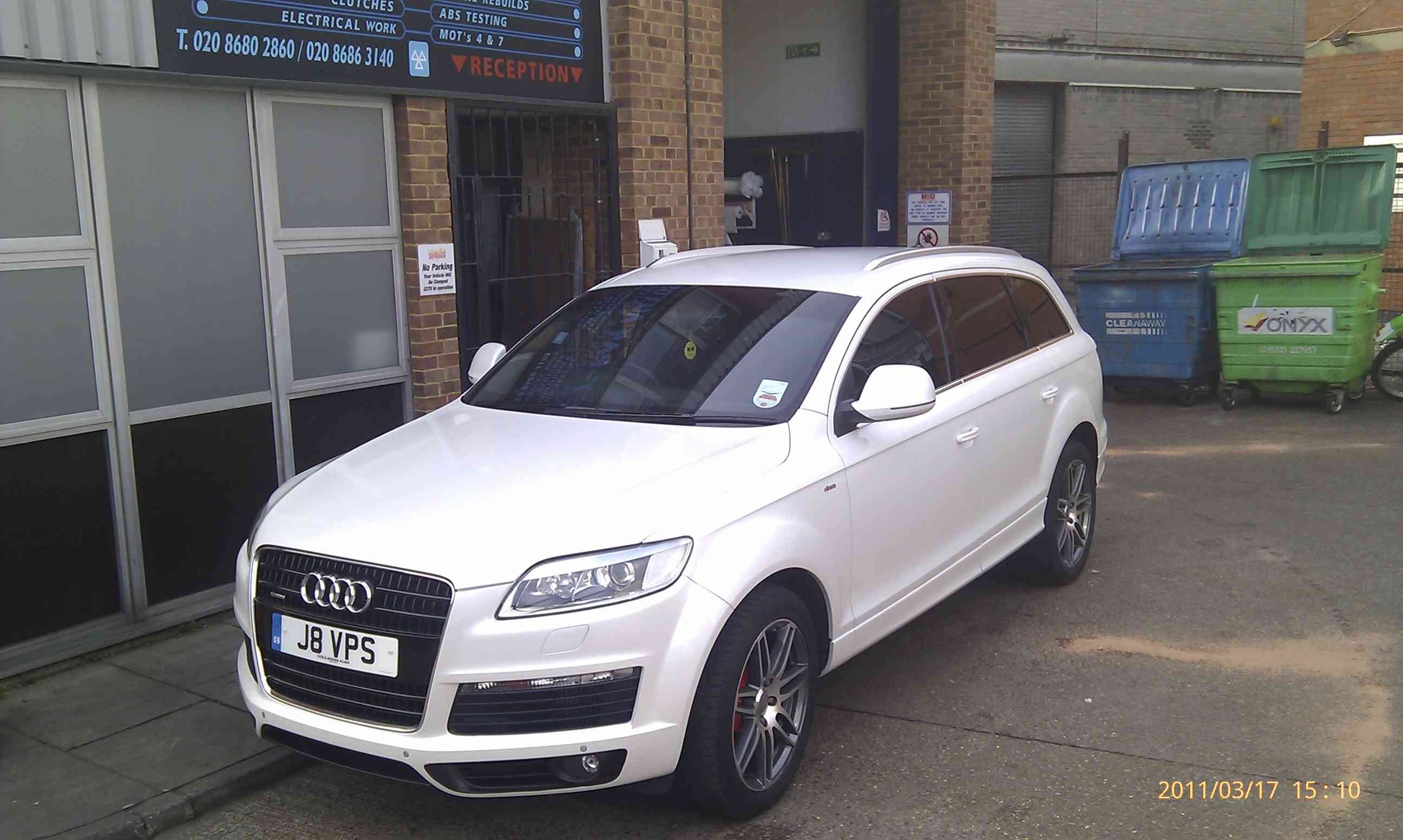

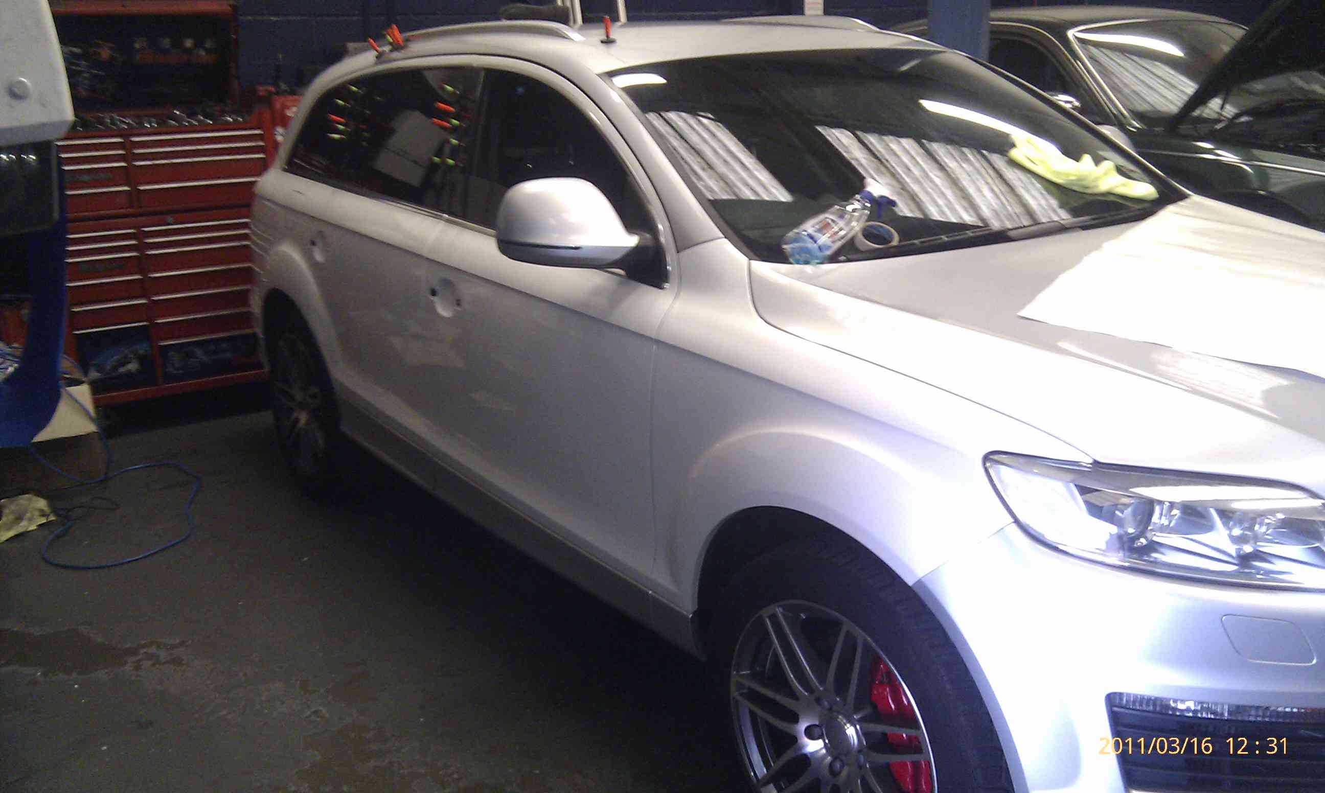

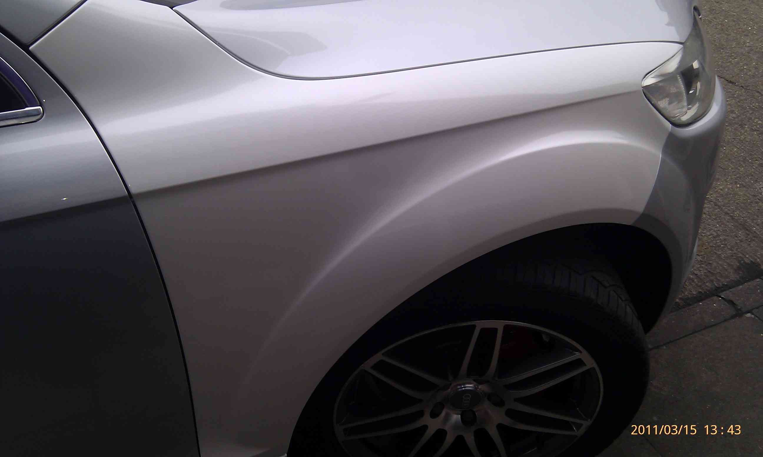

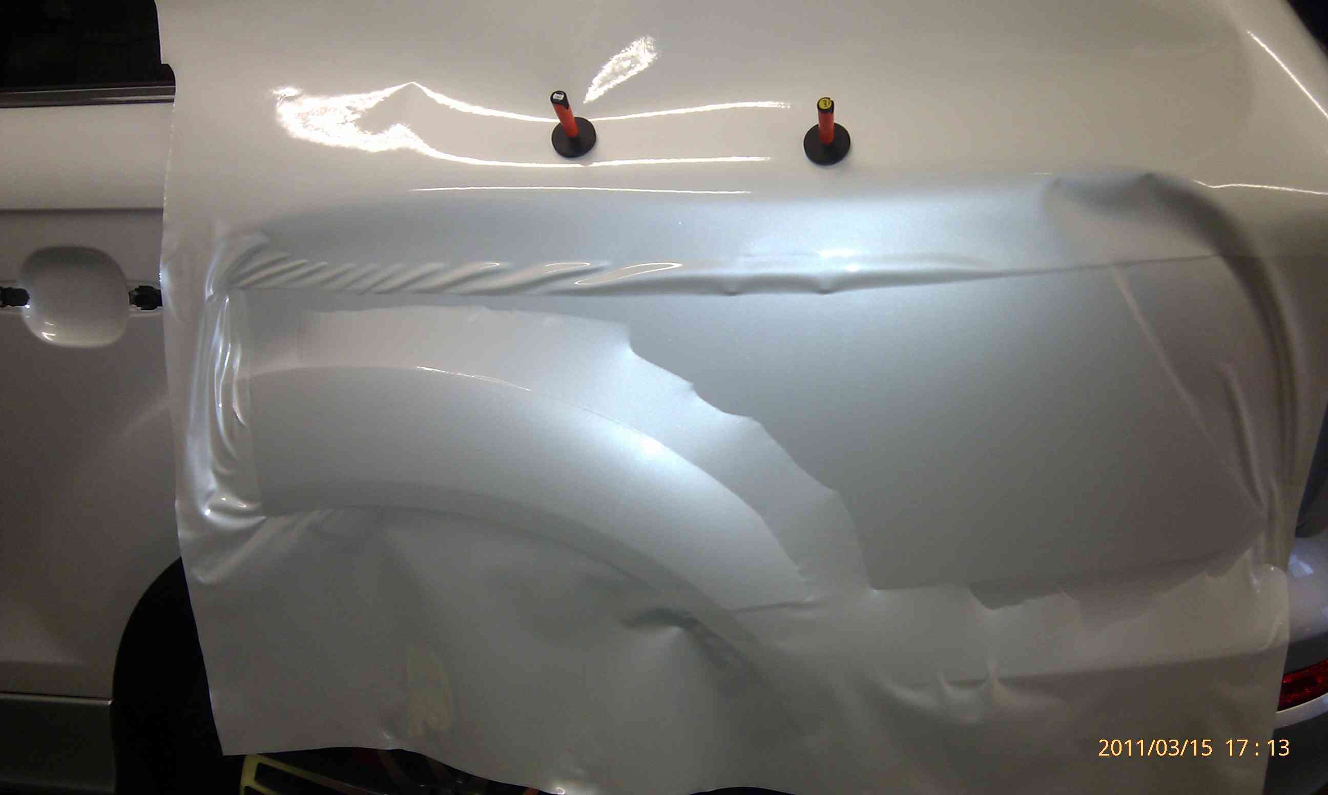

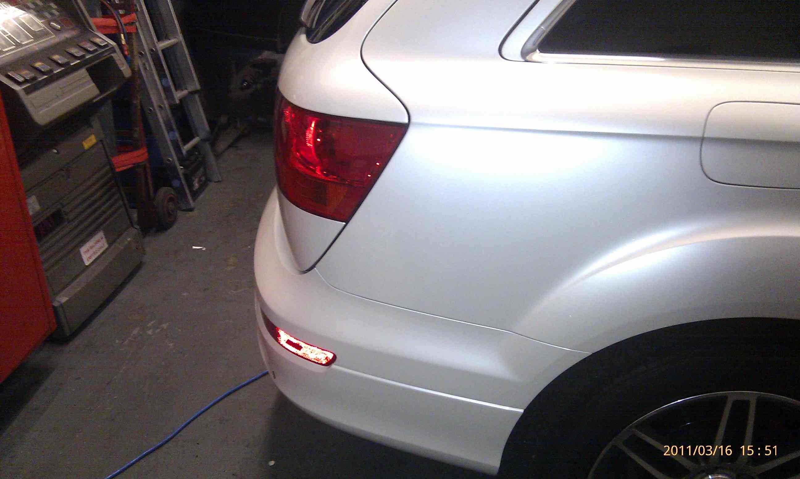

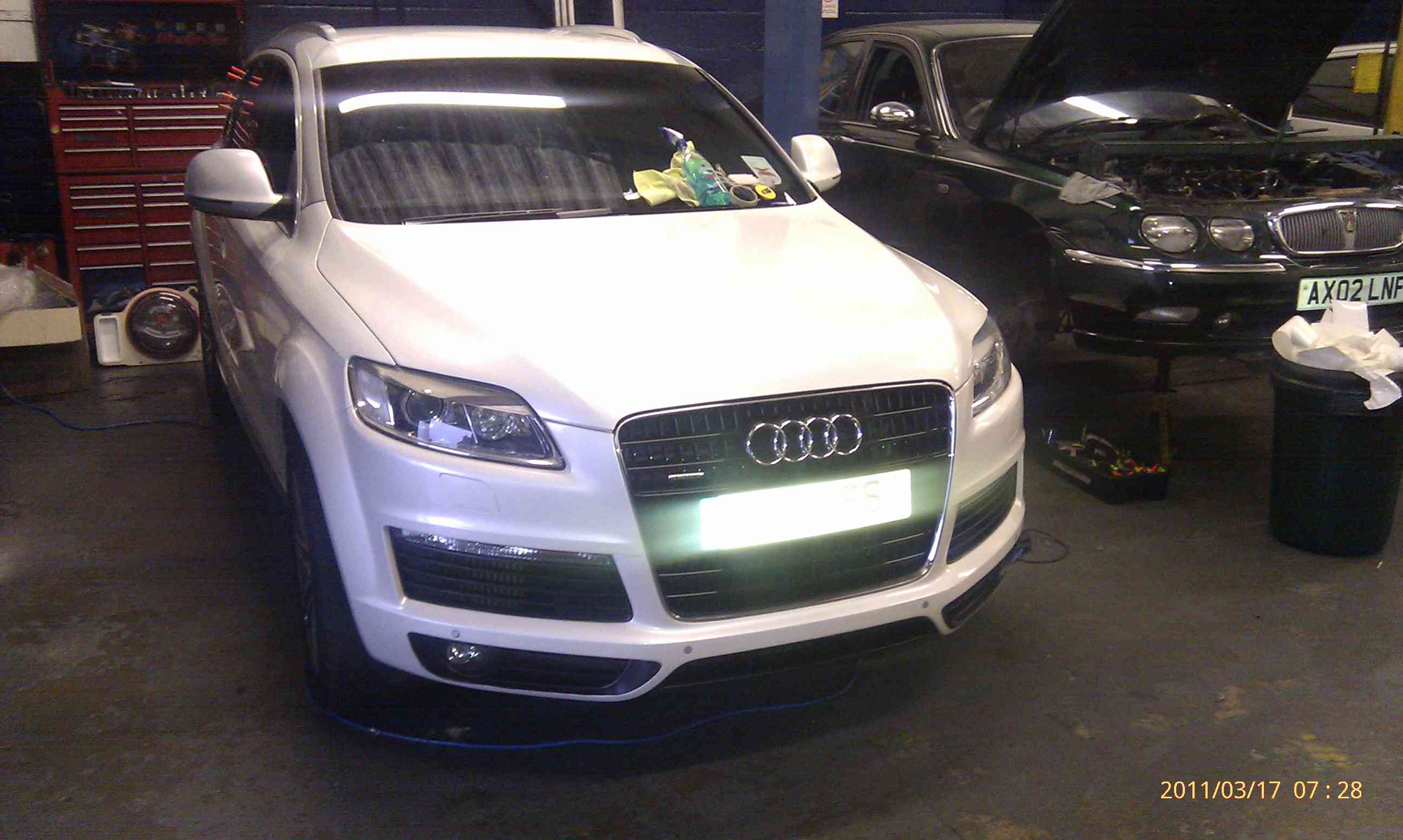

    Hi all been really busy this end did this the other day which was time consuming but worth all the work stripping out door handles etc I did this all on my own except someone to help with the roof and bonnet, just to hold the vinyl. its APA white pearl and I needed 25 meters x 1500mm to complete so around £900 just in vinyl!!!!
    2 and a half hard days later all looked well !
    Rich

    Jon I would say the hexis can be a bit too thin and the apa is nicer to work with and I would say worth the extra money. I also found the material didn’t lose gloss or colour when really pushed to the limits like on the door mirrors
