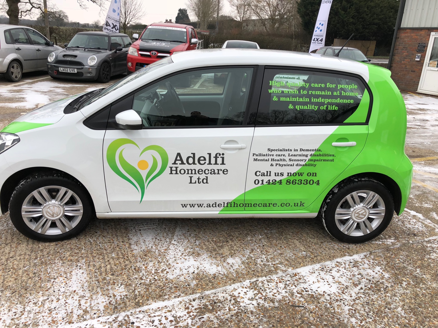

I did have a few panel templates but to be honest, still prefer to flood the whole panel with an oversized print and trim using knifeless tape. I found that on big panels, on the odd occasion that the panel applied a few mm out of square, it was more noticable than having trimmed it to the edges.

That’s shocking. Did you heat the vinyl and push it down after applying the tape?

yes, to the letter!
Very strange. I’ve used it time and time again but don’t get that bad a cut. I’ll tell you what I do just in case. I apply the tape, then run the heat gun along it and push down with my finger again so it’s connected perfectly, I then lay the vinyl over the top and again heat it and run my finger along it again. It’s now perfect and seems to have sealed nicely. When ready I pull it in the direction I’m going and once done, give it a little heat to shrink back as the vinyl will stretch slightly.
Was it done in cold weather Hugh? I’m thinking if the metal of the van was cold this would make the vinyl very brittle
I was actually thinking the same thing, that’s what it looks like to me.
Hi guys,
The car had been in my workshop all day, while -5 outside I was sweating buckets inside wearing a t-shirt in 22+ degrees (all or nothing heater!), The cut line while not heated into place, was firmly applied with thumb first and then felt squeegee, vinyl applied over as per and heated well, allowed to cool, the panel work of the entire car was between 15 & 18+ degrees so I don’t think it the cold, though being the bonnet it was the lower end of the temps, after removing the filament -in the direction of the cut, and the tape removed, it did indeed have a short blast of warm air before being applied.I had varying degrees of cut quality around the vehicle.. from very good to average, but this was particularly bad!
Was it 3m design line Mate, with the red inner ? I have used 25 plus rolls and never has it cut like that, as above I always make sure it’s applied well before removing the filament?
quote Richard Urquhart:Was it 3m design line Mate, with the red inner ? I have used 25 plus rolls and never has it cut like that, as above I always make sure it’s applied well before removing the filament?
hi Rich,
Was the 3M finish line, not design line. Borrowed it from a local sign maker when my wrap cut ran out!
H -
Ahh ok yes I’ve had that, which is why for quality jobs I use design line [emoji6]
