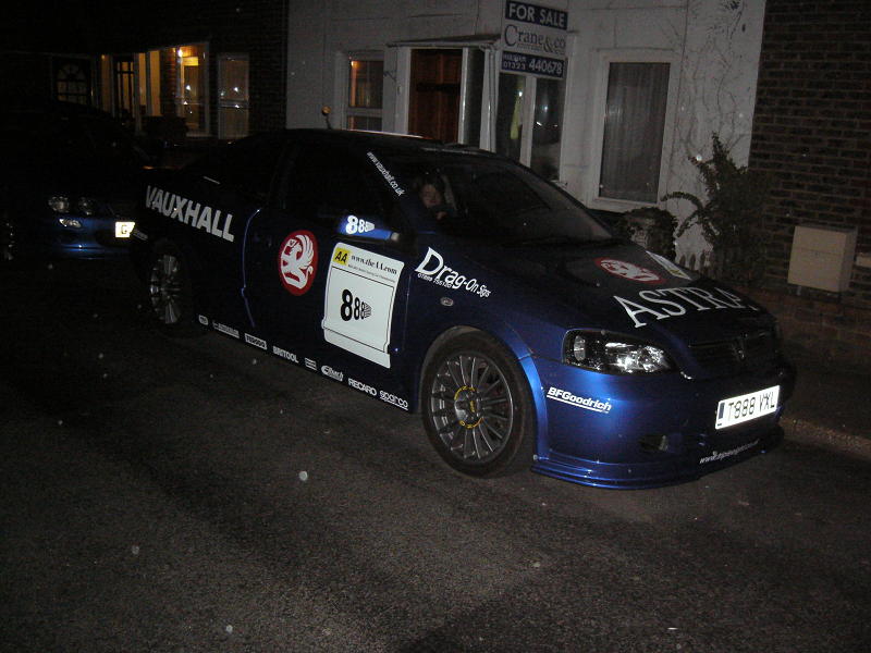

    hey all, first job worth posting in a while,
    fitted it today, cold, windy, but dry !
    its one of only 102 2001 Astra 888 coupé’s built in recognition of vauxhalls touring car championship winning car,
    took about 4 hours of design etc, 2hrs to cut and pre-layer certain bits, and about 4 hours to apply,
    not one of those jobs you’ll really get your monies worth on, but a good advert as my name is where a driver specific sponsors name went,
    the white and red is oracle 751c, first time i’ve used it, i have to say i’m impressed with it, especially when getting it around awkward bits on the fuel cap etc, conforms really well with a little heat,
    sorry about the pics, was dark time we’d cut one last bit i’d fogotten !

    looks good mate well done lots of little bits
    one thing that looks a bit biffy to me is the astra on the bonnet !!!
    but i guess that what was on it
    nice work mate
    February 26, 2006 at 9:27 pm
    thats right richard, the car is as close as we could get it from iffy internet photo’s !
    the proper race car had the arches further up the body too, so we had to just go by eye on a few bits, [/left]

    I see you even fitted the original sign makers sponsorship logo!
    February 26, 2006 at 10:09 pm
    absolutely Pete !!
    the guy who came to me was a real nice bloke (does windscreens so may come in handy too !), he said there were two cars campaigned that year, and the drivers both had their own sponsor there, so he asked if i’d give a discount for some advertising, i said yes, but only in the form of better materials than the ‘standard range’ i would normally use, he agreed, obviously !
    it gave me the chance to work with 751, so although it cost me more than double my usual material cost, it was worth doing to se how i liked it, andhow it behaved compared to 651, i’m well pleased with it, and will certainly use it again if i get the call for it. unfortunatly i don’t get the same discount on 751c as i do 651 so it won’t be too frequently used … yet !

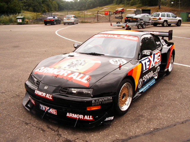

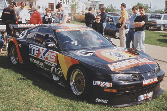

    I get quite a few race cars from circuit and oval racing. Have three Formula Fords to do over the next month.
    Here’s a “Thunder Saloon” I replicated back to it’s livery from ’92
    The first pic is what I had to work with.
    Second Is the finished item.
    When I was at Brands to watch it race, I meet the guy who first done it, and except for a slight difference in colour shades, thought it was a good copy 😀

    i think i’ll use it more for the auto applications, or certainly reccomend it, insist on it in some cases ! i did get a couple of small creases on the larger decals due to the compound curves etc, but in general was well chuffed, stuck like the proverbial, despite the temp being only about 6degs C !
    what impressed me most was how easy it was to conform around odd shapes like the finger hole for opening the fuel cap cover, it was pronounced and with a little heat it virtually wrapped itself !
