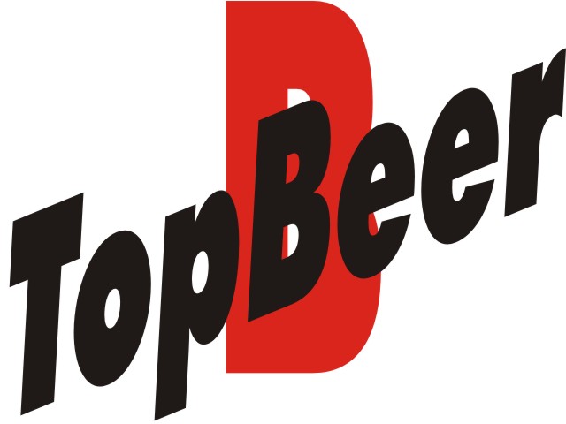

    Great Job Matt, looks really good. Just a quick question for anyone to answer for me really. Sorry it’s a bit of a daft one, but being newish to this it’s one I haven’t really come across yet.
    Anyway, how to you layer up a job like this.
    You can see my three pictures below as examples, I’m guessing that you do it as in the first picture, but is it acceptable to have the small ridge that would appear where the vinyl’s interesect.
    Or would you do it as in the second picture, or the 3rd, but with the third, when the vinyl contracts a bit you would get that small gap between the colours.
    Hope this makes sense and someone can enlighten me
    Many thanks
    Ali
    July 18, 2006 at 10:18 pm
    In this case I would go for choice 3, but bleed the black over the red by a twitch, to allow for shrinkage, this will allow the black to be black without a red outline if you are slightly out of alignment..but better still put a keyline round the black

    I would do it like this

  • Alistair Richards
    July 18, 2006 at 11:03 pm
    quote :
    I would take off the party hat and sober up first before trying to give this one a go
    Maybe it should be like this Phill.. :lol1: :lol1:
    Thanks for the opinions anyway guys, wonder how Matt did it?
    Ali
  • David-Foster-
    July 19, 2006 at 7:05 am
    Yes Lynn’s is the best way 😉 No problem with shrinkage cos it’s got a gap already, and no ridges of overlap.

  • Matt Hards
    July 19, 2006 at 10:11 pm
    Well for this job, the mvm is three with the three overlapped in order. I just overlapped them. You couldnt really see the crease.
